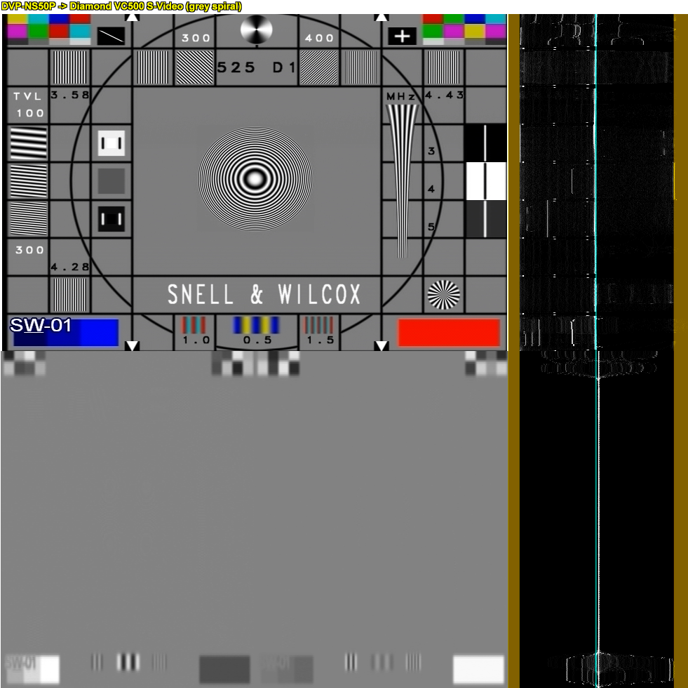

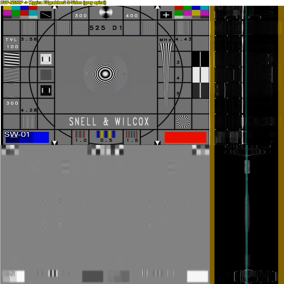

  20. Formerly 'vaporeon800' Brad's Avatar
    Apr 2001
    Vancouver, Canada
    Originally Posted by vaporeon800 View Post
    So here's a new one to chew on. Same player, same cable. Two other capture devices.
    But these two capture devices share a common heritage. In fact I only "installed" one. For the other, Win7 just loaded up the exact same driver from 2009 by Beijing Geniatech Inc. Ltd. without me having to use its CD.
ID:	17690 Click image for larger version
    The name-brand one is clearly better all the way around, but how? Someone did some investigation into these devices here but I don't see a conclusion as to whether the hardware is identical. The chipset is by Conexant and is apparently very similar to the Hauppauge USB-Live2, which sells for about $7.50 more than the Diamond VC500 on Amazon currently.
    Is it possible that the little soldered-on S-Video cable built into the device is what's making the difference?
  21. The Mygica cap has bad levels and is slightly oversharpened. It has dot crawl artifacts in the colored areas and echo noise within a few pixels of vertical edges.
    The Diamond cap has better levels and no dot crawl artifacts. It isn't over sharpened but has similar echo artifacts.
    The layout and isolation of the analog section of capture devices can make a difference in noise, echoes, sharpness, etc.

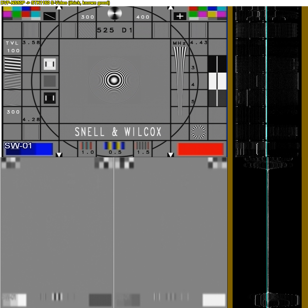

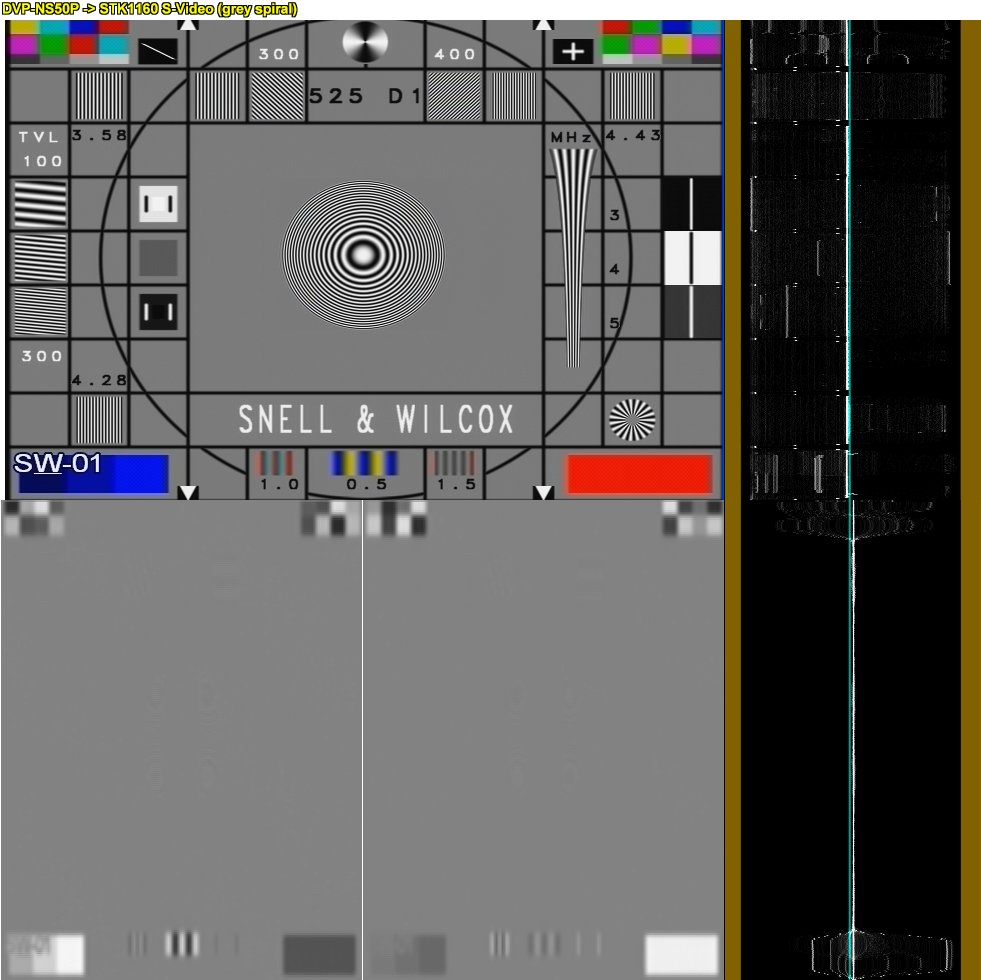

  22. Formerly 'vaporeon800' Brad's Avatar
    Apr 2001
    Vancouver, Canada
    I could swear the same brand of dollar store cable worked fine in another environment (RV park vs apartment downtown) so I guess it depends on the local EMI.
    [Attachment 17476 - Click to enlarge]
    [Attachment 17475 - Click to enlarge]
    Back to the Easycap results: I reacquired the cable that I was pleased with and it didn't come from the dollar store at all. I definitely didn't buy it deliberately, so I don't have any clue as to its actual origin. I think someone mailed it to me with a DVD recorder I bought. The jacket says such things as "e300060 awm 2919 30v vw-1 csa ll204790 ft1 low voltage computer cable", if those mean anything to anyone.

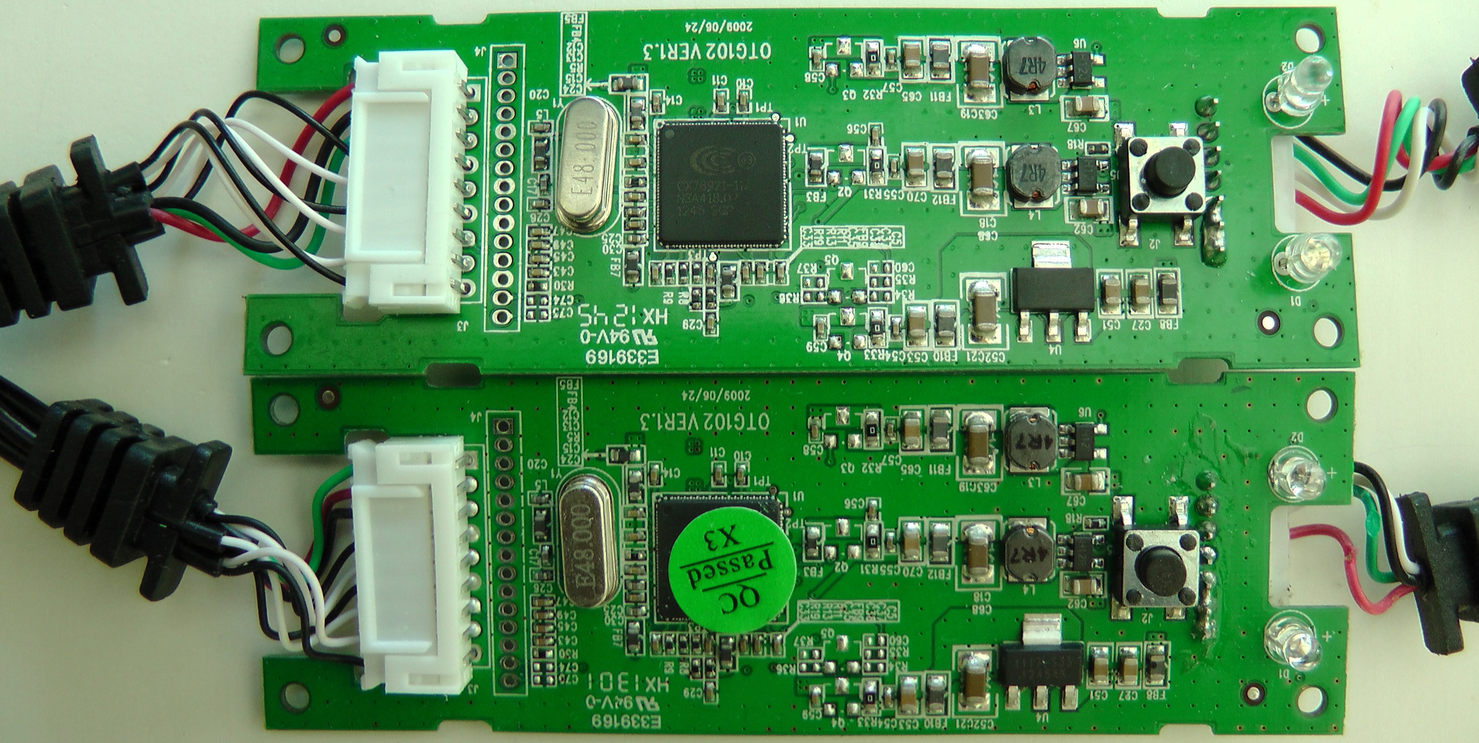

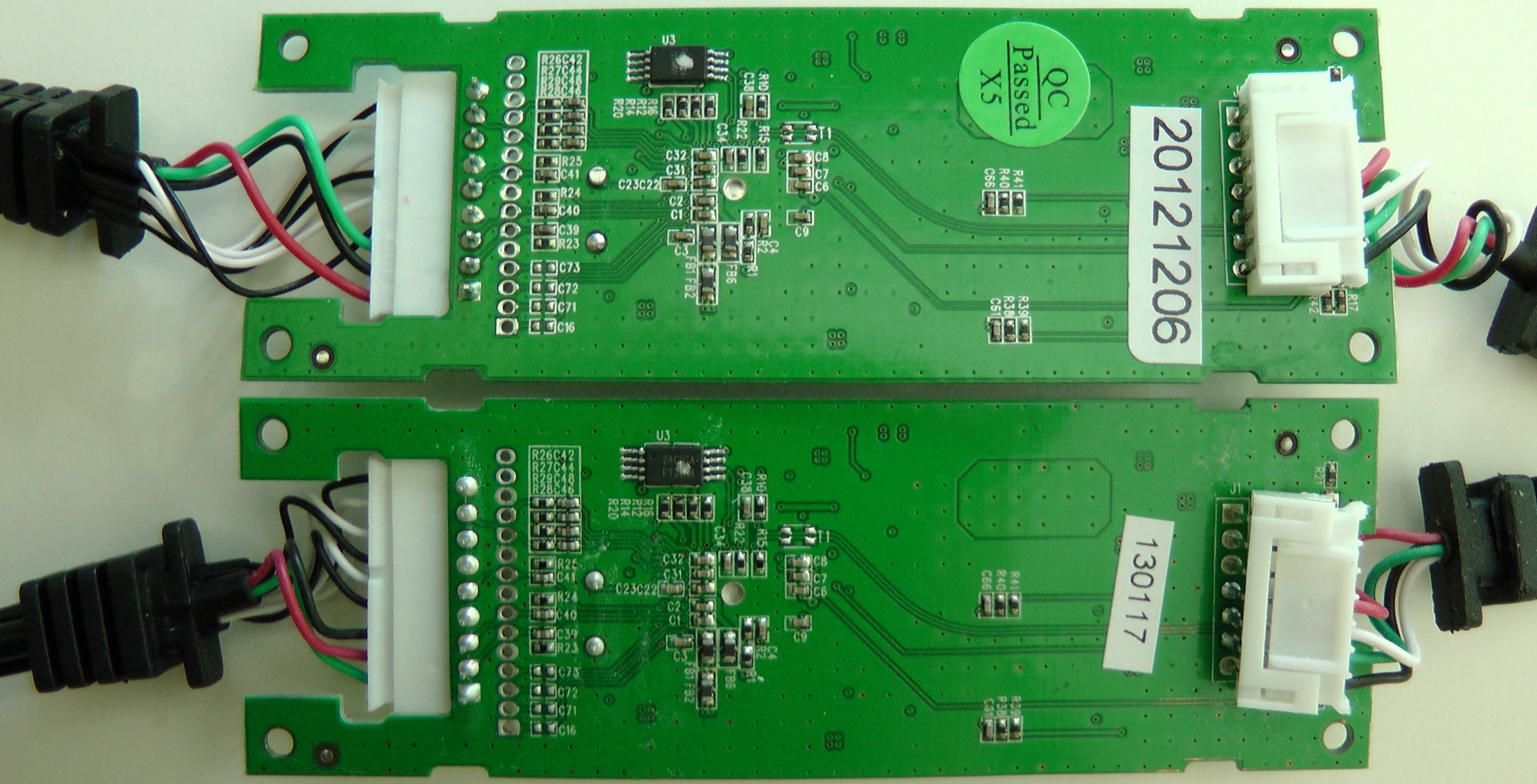

  23. Formerly 'vaporeon800' Brad's Avatar
    Apr 2001
    Vancouver, Canada
    I was rather shocked to discover that they are virtually identical inside. There are little differences here and there, but if anything the Diamond (bottom) is the one that looks more shoddily constructed.
    I do notice that the top three wires on the left, which come from the S-Video input cable, go red-black-green on the Mygica as opposed to green-red-black. Could it be miswired?

  24. Interesting, could probably be miswired, but havenīt really followed whatīs going on. What are the artifacts/issues you get?
    Cause if non of the wires are correct, i donīt get how you should be able to get a picture at all as nothing should be where it should.
    Opposed to Composite at S-Video where chroma and luma is on both and not separate, and the artifacts come from it decoding as they should be separate, which getīs a nice artifact that is flipping all over the place.
  25. Originally Posted by vaporeon800 View Post
    Is that the devices used in post #230? Most of the differences could be explained by different default settings. Sometimes chips are configured partly by their input pins and there may be different value resistors or capacitors connected to those pins. That might explain different luma/chroma separation by the comb filter and the different sharpness.
  26. Formerly 'vaporeon800' Brad's Avatar
    Apr 2001
    Vancouver, Canada
    Post #230, yeah. Guess there's no way to know without some tool to probe the chip itself.
