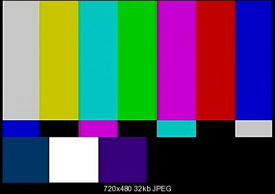

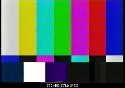

    I wondered if it was menu-only as well, but it is not.
    Some of my SVHS footage was done using Panasonic professional decks when I used to work in video production (VITC time code and all). That being said, we tended to record 1 minute of SMPTE color bars at the beginning of the tapes. The upside is that it makes it incredibly easy using clrtools to import my footage because I could nail the colors, brightness, and saturation using the virtual vectorscope. The downside is that I could immediately see the same checkerboard artifacts in the actual video signal that I saw in the menus all up and down the solid color bars.
    Zooming to 300% on any area of captured footage that has some solid-ish color areas and you can see the artifacts as well. I don't have any other VCR's to compare with, but both my 101 and 7600U have the exact same artifacts using the s-video out ports on playback regardless of the TBC, DNR, or digital r3 settings. I never noticed it back in the days of CRT's probably because of the actual analog noise + interlace masking it. It's very easy to see now in the 1080 LED world.
    I'm going straight from the deck into a Hauppauge 2250 card (artifacts are present when recording into my standalone LiteOn DVD recorder or my DV camcorder so it's not the Hauppauge).
    So far I'm using dotcrawl.vdf with both extreme settings and the checkerboard is removed.

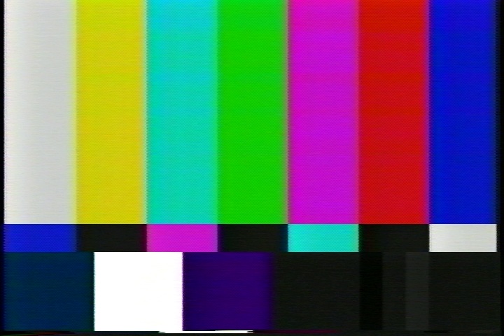

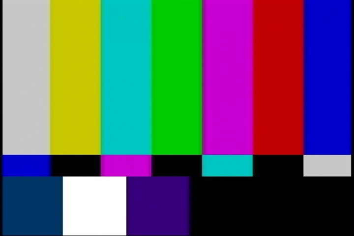

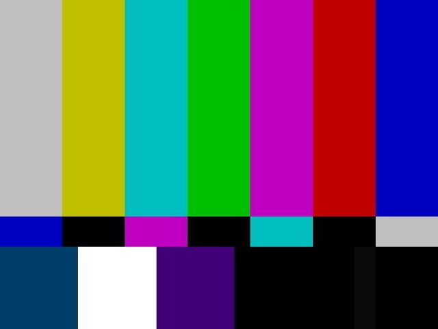

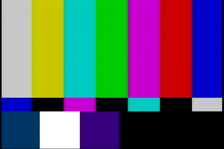

    Here's the results. DSC00099.jpg is the original file in the memory of the camcorder connected via S-video to Hauppauge. med1 and med2 have the worst crosstalk. thin1 has mild crosstalk. med1gold and thick have no crosstalk.

  15. Thanks for the samples. There's definitely a difference.

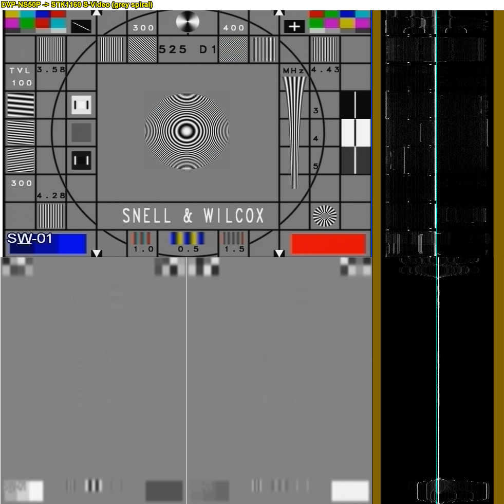

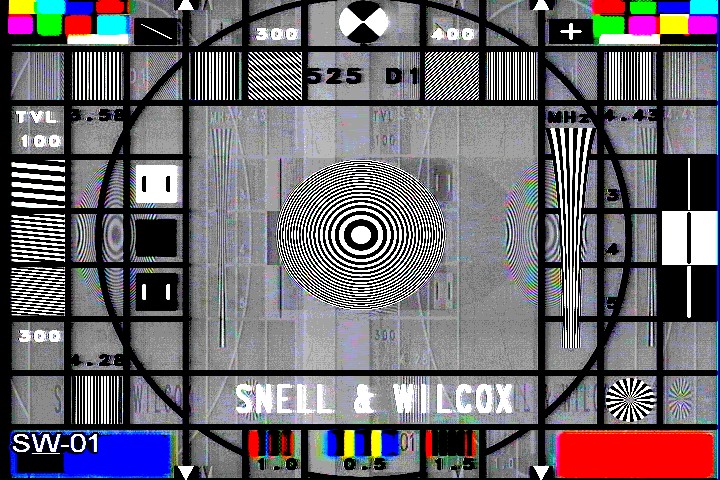

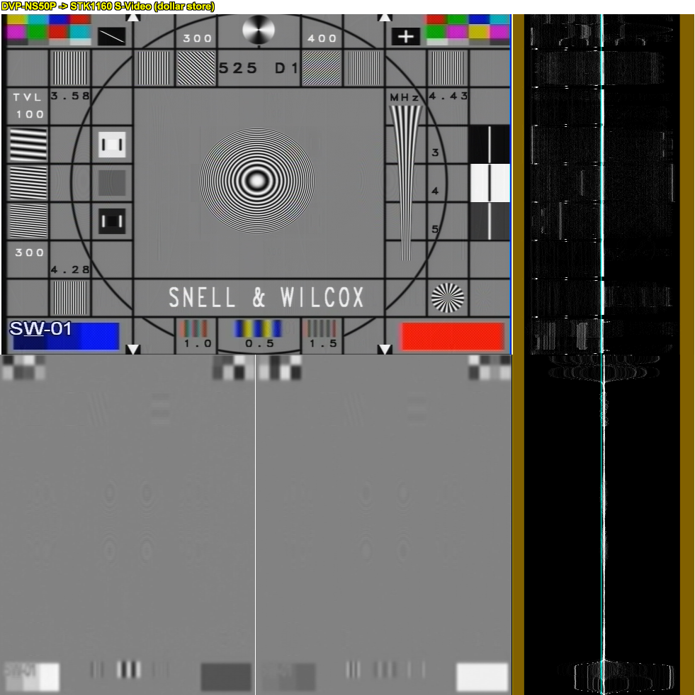

    Still looking for a reasonably-priced, good S-Video cable locally. I could swear the same brand of dollar store cable worked fine in another environment (RV park vs apartment downtown) so I guess it depends on the local EMI.
ID:	17476Click image for larger version
    AVISource("Sony STK1160 - S-Video.avi")
    AddBorders(2,0,2,0,color_white)
    StackVertical(StackHorizontal(UtoY(),VtoY()))
    Histogram()
    ConvertToRGB().AddBorders(0,20,1,0,color_white).Subtitle("DVP-NS50P -> STK1160 S-Video (dollar store)",size=16,x=2,y=0)
    Trim(175,0)
    AVISource("Sony STK1160 - better S-Video.avi")
    AddBorders(4,0,0,0,color_white)
    Histogram()
    ConvertToRGB().AddBorders(1,20,0,0,color_white).Subtitle("DVP-NS50P -> STK1160 S-Video (grey spiral)",size=16,x=2,y=0)
    Trim(122,0)
  23. Formerly 'vaporeon800' Brad's Avatar
    Apr 2001
    Vancouver, Canada
    Apparently one has to be very careful shopping for video cables in a computer recycling/thrift store.
    The "grey spiral" cable is in fact an Apple ADB cord, which Wikipedia claims may be used but could deliver lower performance because of the impedance. And I got another one that certainly looks like an S-Video cable, but it's only giving me a black and white image.
  24. That's some really bad echoing on your cheap s-video cable. That would not be caused by local EMI.

    The Bluejeans Y/C s-video seems pretty clean to me. They sure look better than the cheapies I tried, and they did a dance around noisy and much more expensive stuff. My favorite s-video was a budget job with a unique connector that was the only thing that distinguished them from others. But they seem to have disappeared from the market. When I saw this happening a while back, I bought up every one I could, from Circuit City, Amazon, and monoprice. I also tried the Acoustic Research Pro-II, which had decent color and contrast and very little noise, but the image is a bit soft to my taste. The cheaper blue-jacket AR's are a no-no. I've been thru so many s-video wires from $0.99 to over $300 (I returned the later immediately) that I filled two big plastic milk cases with them. They were all rejects that I tried again and again on different material and different video and capture setups, and have been discarded. The worst s-video I've seen were from Monster and BetterCables. But you're welcome to try.
    Test patterns do give some important info about a wire. In the end, playback of real-world video is the final test. The same is true of wire, cameras (ever see an analysis of the noise in Canon's popular digital cameras?), amplifiers, and everything else. The old Dynaco line of amps would test out with high levels of IM distortion. But they sell for up to $10,000 today, are still used in many cinema houses, and are prized by many audiophiles. Test patches certainly do tell you something, but not everything.

    i looked closely, and the one marked 'store' had more noticable hatches than the cheaper ones, though both have problems. not saying that you have poor cables. but i don't know your method/process with respect to your test pattern..how it is played back and recorded and captured. my problem with test patterns these days is that people are using "used" patterns, i.e., jpegs made into mpegs etc., and have mosqueto and other artifacts or noise in the test patterns. patterns that have flaws in them imho gives skewed results about a captures capabilities. these patterns need to be properly tuned for accurate results. i'm working on one pattern now, (cleaning it up, rebuilding some of the details to remove the noise etc) hopefully will have it finished today so i can test it with some equipment.
  29. Originally Posted by vhelp View Post
    Those are echos of the main signal. Contrast enhanced:

    What I don't understand is how they are at 2x the frequency of the signal.
