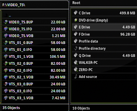

  20. Okay it seems maybe both of you has missunderstood me here.
    The picture above, and what i am Currently talking about is ONLY in Consoles where they have the Cheap hack.
    What i mean is, why does S-video look so much better in resolution (itīs like 320x240 to 640x480), when it isnīt even S-video, but composite transfered over both?
    When i am going on the VCR as sanlyn is talking about.
    VCR -> DVD, Composite to S-video, i donīt get any improvement, itīs just worse.
    Though for dvd material, S-video looks much better than Composite, IF you ignore the crosstalk (Which i canīt ignore for important stuff).
    But i can add that i am also curious to why i get the Herringbone crosstalk in my DVD, as a random VCR-DVD combo doesnīt get it. Concluding something is wrong, probably cheap splitter.

  27. Zerowalker, the evidence of all your chroma/luma crosstalk problems is spread over several threads and many posts. I suggest you summarize all your evidence in one post, maybe even start a new thread with it, so everyone can easily analyze all your situation.
  28. Originally Posted by jagabo View Post
    First the answer to the First about the Resolution.
    I see, then itīs probably as you say, but i really like that the S-video doesnīt Blur the text anyway, but a Console gives full resolution which a VHS doesnīt.
    Now to the other Quote.
    Yes i have been kinda spreading, but there is some difference between them, and thatīs why i have been asking here also.
    When i first captured Xbox, one posted in my other thread and linked this one, here it was all the same (checkboard noise).
    Then the discussing stopped, and i got another "problem" with the DVD, but itīs not the same look as the checkboard noise.
    I then started the question about the Xbox checkboard noise again to ask why S-video looked to much better for me Even with noise.
    Then you answered that it was more an Illusion thanks to the colors, but that there is some improved Luma sharpness.
    I canīt really post the different stuff and let people analyze, as with the consoles atleast, itīs as you say, just composite over S-Video, not much to do except dot crawl filter, though it works better than using composite for me atleast.
    The DVD is another issue but similar, and donīt know what to make of it, itīs probably some other cheap way of Y/C splitting, but not as "Clean" as the consoles which seems to completely just send composite.
