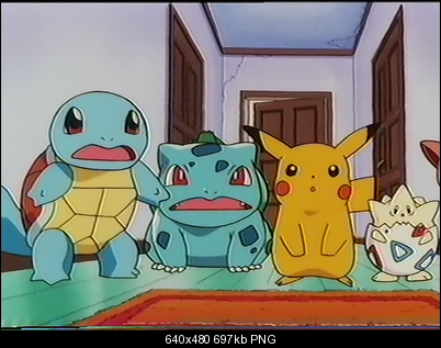

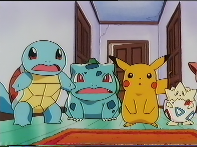

    Some of the bad stuff in Normal.avi can be fixed up a bit.
    This is an unprocessed Frame 13 of the original Normal.avi, as posted earlier:
    Frame 13 after some levels correction and trial efforts with a few filters. With moire time to fiddle and experiment, results would probably get better:
    [Attachment 10964 - Click to enlarge]
    But the wiggling lines and the ripple along the bottom will most likely require a line tbc or pass-thru.

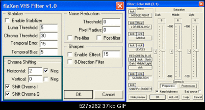

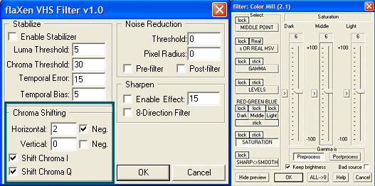

    There are hundreds of plugins and tricks you can use on any video. I used more than a script. I used Avisynth mostly for noise, VirtualDub for color and a little chroma shift, and TMPGenc Plus 2.5 for ghost reduction. You don't have to do it the way I did; there are hundreds of ways of cleaning video. I could have spent more time tweaking, trying other plugins, etc., but I had to repair a PC last nite for a customer.
    I loaded the AVI into Avisynth using the script "Normal2.avs" -- attached at the bottom of this post.
    That script solved a few problems, but there was more to do. Contrast and color correction actually helps, especially in taming some of the halo brightness and making the lines look a bit darker (the AVI is too bright). After running nthe script I loaded the AVI into VirtualDub and used these filters:
    Flaxen moved color shift 2 pixels to the left. The green square below outlines the Flaxen settings, I didn't use the others in that filter. In the right-hand image is the ColorMill setting: I raised saturation for all three colors by 6 points. The ColorMill saturation control is at the bottom-left of the image.

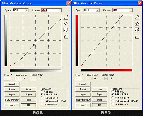

    Getting contrast was important, and lowering gamma (midtones) and brights helped a lot. For this I used two VirtualDub gradation curve filters, one for primary correction and the other for secondary tweaking.
    Primary Correctiona:
    Gradation curve, RGB (overall luma, gamma, lower midtones) and Red primary correction:

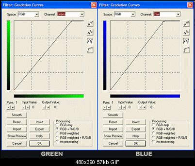

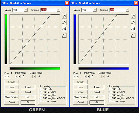

    Primary corrections for Green and Blue:

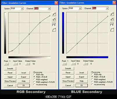

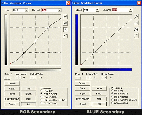

    Secondary Corrections:
    Secondary (tweaking) for gamma, darks, brights, and bright Blue:

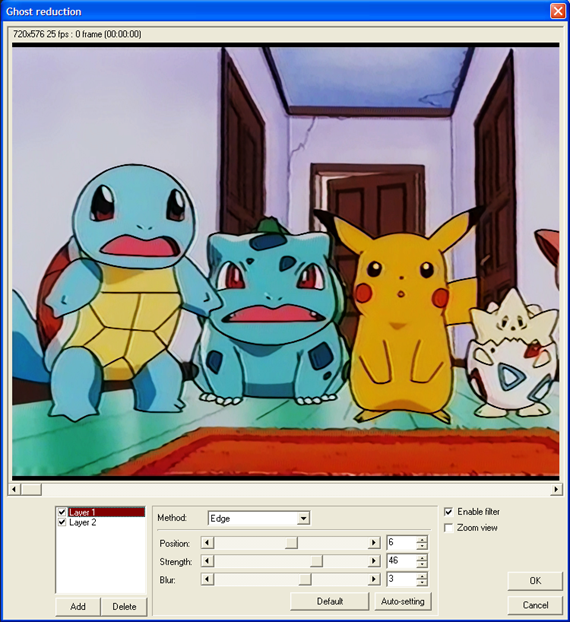

    Then I loaded the AVI into TMPGenc Plus 2.5 for its Ghost Reduction filter in Advanced controls. Avisynth and VirtualDub have a couple of ghost filters. In my experience, none of them seem to do a damn thing. The ghost filter below shows the TMPGenc control panel for edge ghosting (1 for right-edge ghosting, #2 for the left):
    The AVS script is attached below. These techniques are not the only way to do it.
    [Attachment 10974 - Click to enlarge]
    A second gradation curves filter was added for Secondary (tweaking) for gamma, darks, brights, and bright Blue:
    [Attachment 10975 - Click to enlarge]
    [Attachment 10976 - Click to enlarge]
