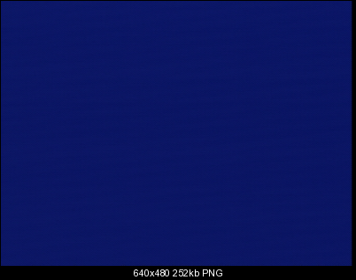

    First, a note about using the Panasonic ES20 for pass-thru. The darn thing puts out some vague rolling lines. They change rolling speed now and need. I mentioned this earlier. The lines show up in dark areas and large bright areas such as sky. I see this on the ES10, ES15, and ES20. Here is a cap:
    Direct link to about 6 seconds of this noise (NTSC/MPG):
    http://dc451.4shared.com/download/jGGZkxXH/B1_Panny_noise.mpg
    This image is from the capture using composite cable, straight into the capture card. No tbc. Indeed, it is definitely copy-protected. Straight playback with no tbc makes it look dingy and noisy. Typical effect.

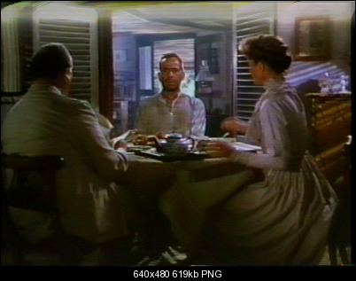

    A fairly clean frame using composite-only:
    NTSC/MPG video of this scene, composite-only, no tbc (copy protection effects):
    http://dc452.4shared.com/download/sSlm6D3n/A_straight_AR.mpg

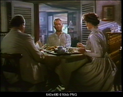

    The Panasonic ES20 wasn't affected by copy protection. NOTE: It don't always happen this easy. Depends on the tape. Sometimes the full-frame TBC is required. ES20 with composite-only, tbc pass-thru, DNR on:

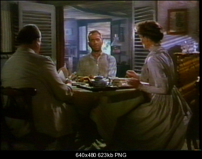

    NTSC/MPG video of the same scene:
    http://dc387.4shared.com/download/LUfsQ845/C_Pan_AR_DNR.mpg

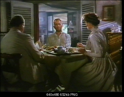

    ES20 as pass-thru, composite in/svideo out, DNR on:

    Toshiba D-KR2 as pass-thru, composite in/s-video out, no DNR, y/c turned on:

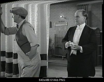

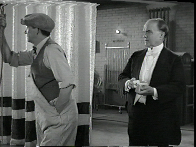

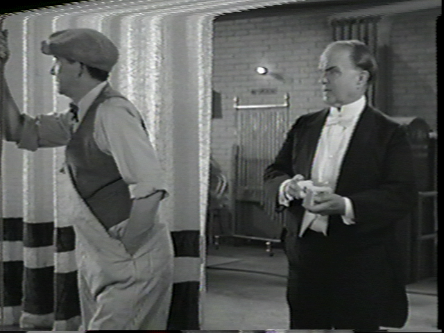

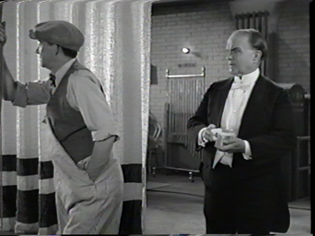

    Sample1: working with bad tape that displays tearing. The VHS tape is Swing Time (1934). Tearing along the top. All played on the PV-4662. I fiddled with tracking, but it was no use. The Toshiba cleared almost all of it. Composite in / svideo out on all:
    G: AVT-8710
    NTSC/MPG video of this scene: http://dc260.4shared.com/download/7q2vE55g/G_Swing_AVT.mpg

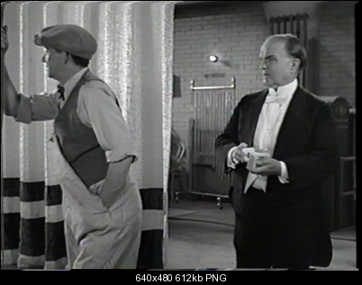

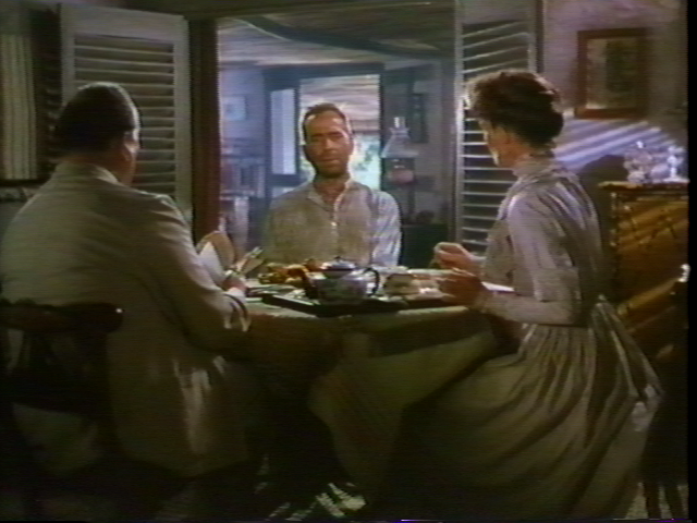

    H: Panasonic DMR-ES20 as pass-thru:
    NTSC/MPG video of this same scene: http://dc365.4shared.com/download/8paBbmRV/H_Swing_Pan.mpg

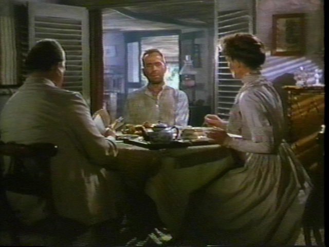

    I: Toshiba D-KR2 used as pass-thru
    NTSC/MPG video of this same scene: http://dc193.4shared.com/download/xFR77wdE/I_Swing_Tosh.mpg

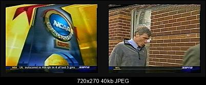

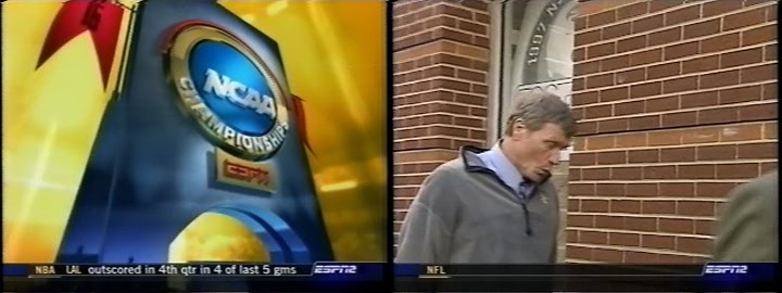

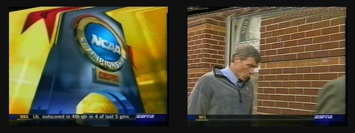

    Sample2: A better fix (sometime you just can't explain why). A football broadcast on ESPN, a VHS recorded at 6-hour rate probably on a Panasonic over SD digital cable. Abused tape, football fanatics like to play with fast-forward/replay/repeat and ruin tapes. These captures also used composite-in/svideo-out (same cables as above). No color or levels work, I had to get this VHS transfer to my nephew for his graduation, and the noise and damage were enough to handle on their own. This was 4 or 5 years ago. The borrowed tape was played on a Panasonic PV-8661. Pass-thru: Toshiba RD-XS34. No full-frame tbc required:
    The "bad" sample clip was reduced in size and given borders, so the full damage wouldn't be hidden by a CRT's overscan. 352x480. The "fix" sample was not resized (704x480 NTSC). The only filter used on the "fix" version was NeatVideo.
    Two images from the "bad" initial capture, no tbc:
    2 images from the fixed version, with Toshiba tbc pass-thru
    damaged video: http://dc201.4shared.com/download/XkrgWcwB/Sample2_bad.mpg
    fixed version: http://dc432.4shared.com/download/Lh8bM50i/Sample2_fix.mpg

    But I think they are related to dot crawl. Maybe from a poor dot crawl filter. Using some other device to perform the dot crawl removal (and then running s-video from that device to your capture card) might help -- if that device has a better dot crawl filter than your capture card. The best solution, of course, is to use an S-VHS deck with s-video output so the video never goes through a composite stage.
    Dot crawl cannot be 100 percent removed in software or hardware without damaging other parts of the picture. That's why it's best avoided in the first place.
    The bright line to the right of the black line is a halo (2x point resize):
    That bright white halo (and the slightly bright halo to the left of the black line) wasn't in the original picture. It was caused (mostly) by a sharpening filter in the VHS deck. VHS is inherently low bandwidth (horizontal resolution) so many decks include a sharpening filter in an attempt to make the video look sharper. The result is oversharpening halos.

  29. Banned
    New York, US
    The door should have been perfectly straight and still. That is what a line time base corrector is supposed to fix. Full frame TBCs may or may not include a line TBC. The TBC in the Panasonic ES15 DVD recorder includes a line TBC:
    As does the ES10 and ES20 -- along with RF noise from their poorly filtered power supplies. I don't know if anyone noticed (probably not) but the Toshiba's line tbc did better work fixing tears than the Panny did. I noticed that about the high-end Toshiba VCR's from the late 90's, whose built-in TBC's made JVC, et al, look sloppy -- and without eating tapes. I should never have sold mine, but . . .
  30. Originally Posted by sanlyn View Post
    Mine doesn't seem to have that problem. Not like your earlier sample. You can see lots of sample caps in the thread I linked to.
