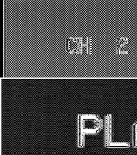

    Why you swap vhs decks? Try to replace VCR with DVD player and see what you will get. EXCLUDE all devices between DVD player and your capture card. If you see no artefacts, add TBC and re-check....
    The type fo errors on your screenshots is CROSSTALK, you can find similar images in google.
    http://en.wikipedia.org/wiki/Crosstalk_%28electronics%29
    here's your problem sample
    http://avisynth.org.ru/docs/russian/pictures/externalfilters/gcomb_off_election.png
    You can also use GuavaComp to reduce effect

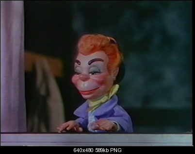

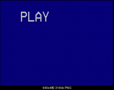

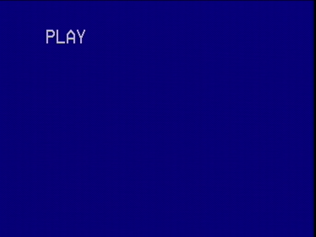

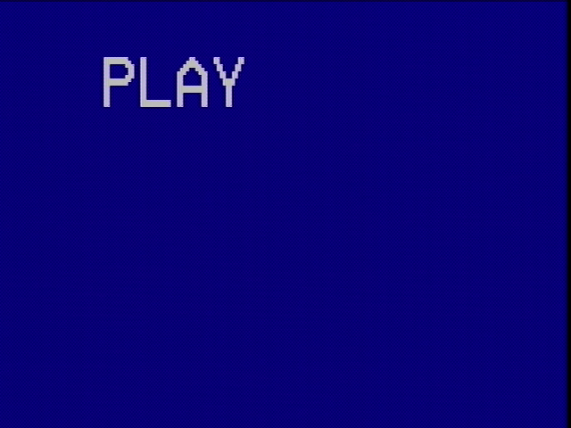

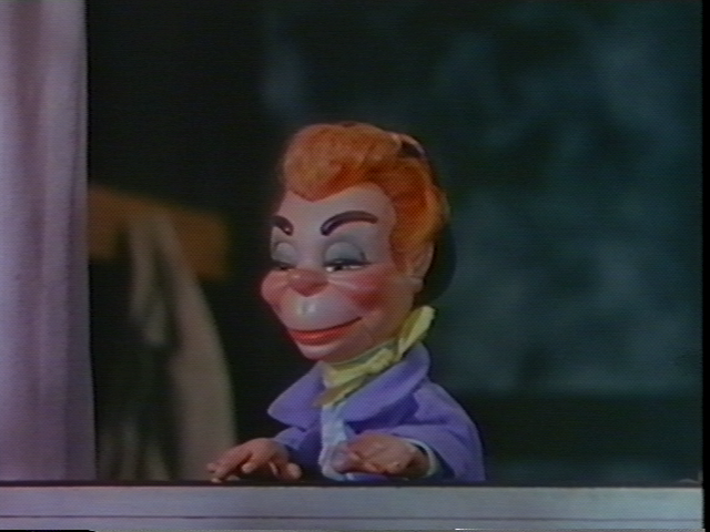

    Pictures 1 and 2 ("PLAY" and "TBC")
    VCR > composite > RD-XS34 > svideo > AVT-8710 > svideo > AIW 7500 > VirtualDub > AVI
    Blow up the image any way you want: you'll see a fine-textured diamond crosshatch pattern in both images. The usual denosiing kills it, but I'm guessing that it does cause some comparative image softening.

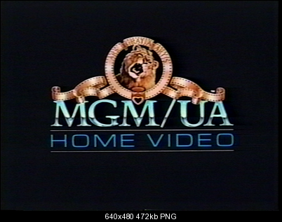

    Picture 3 ("NO TBC")
    VCR > composite > RD-XS34 > svideo > AIW 7500 > VirtualDub > AVI
    diamond-studded pattern not present.
    Fortunately using the RD-XS34 for pass-thru seems to eliminate copy protection problems on my tapes, without the help of a full-frame tbc. This is a 12-year-old tape. From the unprocessed original captures.

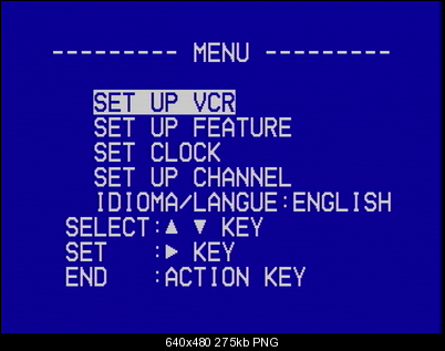

  14. Can you provide a short sample of the blue screen cap?
  15. Hmm yeah, nothing to brag about imo. I prefer a sharper noise personnally for better removal later. As far as chroma noise both caps have some and haven't used any dnr so...
    Also, the size font on your menu has been well chosen it seems, a multiple of 8 perhaps ? but that wasnt enough to fool me

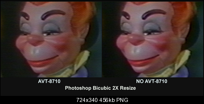

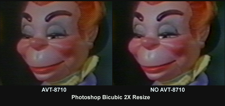

    I never captured menu screens from the session without the AVT-8710. But here are two images from the same video.
    Top image = AVT-8710 in capture setup. Bottom = same setup without AVT-8710. The bottom image had a slightly lower brightness setting in VirtualDub capture to rescue highlights in a later shot from this sequence.

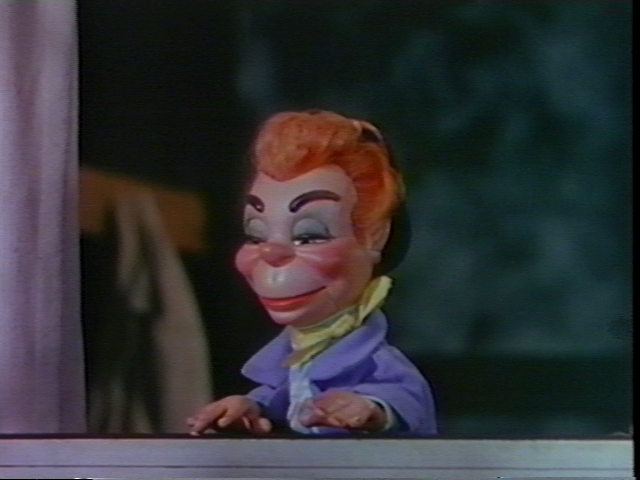

    See the AVi posted for jagabo, above. The frame I posted was the first frame in the capture that had onscreen characters. The font was reduced by the VCR a few frames later. The AVI shows the full sequence in YUY2, unprocessed.

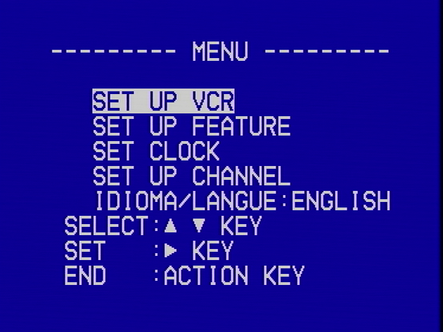

    If anyone still cares (likely not), I made a full-screen menu capture to compare earlier images, and to show a cleaner image that does not use the AVT-8710 with s-video in the capture circuit.
    Panasonic PV-8661 composite video out (Acoustic Research Performance Series composite cable) ->
    Toshiba RD-XS34 recorder as line-tbc pass-thru, s-video out (y/c 3D filter turned on) ->
    ATI AIW 7500 Radeon, s-video input ->
    VirtualDub capture to YUY2 huffyuv
    AVI Converted to RGB32 in Avisynth and copied in VirtualDub
    PNG made with Photoshop
