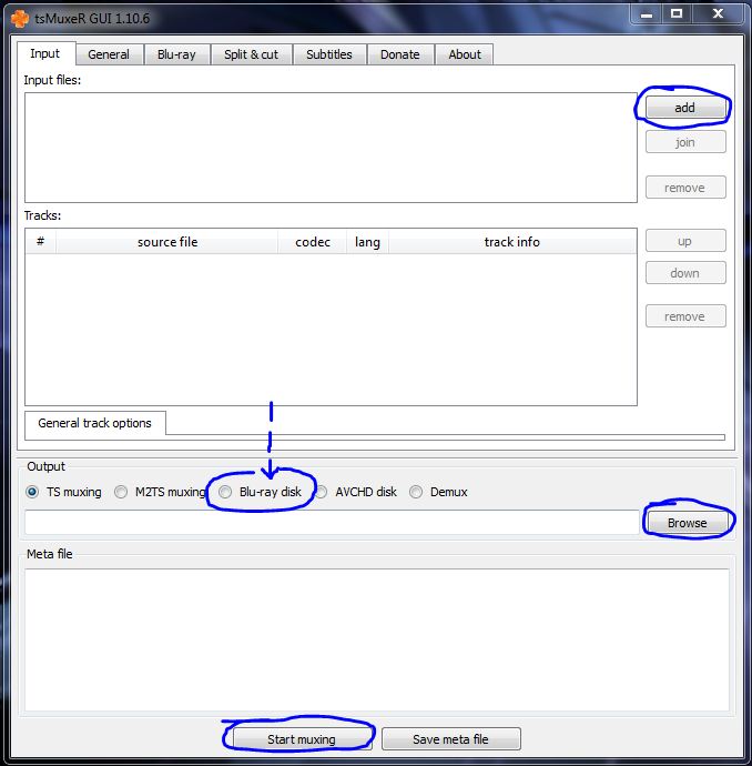

  2. Try tsmuxer, It can make a avchd, ts or bluray disk from your avc/h.264 or perhaps mpeg2 video as it's bluray standard.
  3. multiAVCHD can do simple menus and output to Blu-Ray. Not as simple to use as tsMuxer.

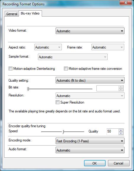

    Woops, I finally found the answer myself, but thanks for those suggestions, I may try them also.
    In Nero there's a SmartEncoding option. Apparently SmartEncoding means it's smart enough not to re-encode stuff that is compliant with the type of disc you are trying to make. The default setting was "Auto" which you would think would do what I want. When I set it to "Enabled" it quit trying to re-encode all my stuff. At the end of the wizard it had a "Smart encode video ration: 99.3%", which basically means it was going to use about 99% of my video file unaltered with just a little bit of re-encoding around my cut points.
    I must say I don't favor Nero's default setting behavior, but I'm glad I was able to do what I wanted finally, so maybe someone else will find this useful to know.

    Next point: What about checking Motion-adaptive Deinterlacing and Motion-adaptive Frame Rate Conversion? Good idea?
Name:	Nero Vision 10 Encoding Options.jpg
    And how about Super Resolution?
