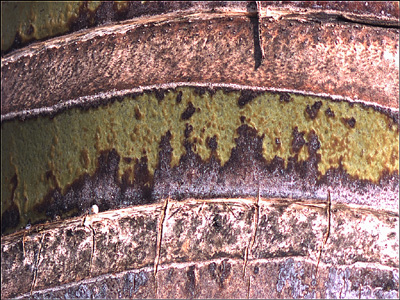

    The issue is that using my CCD camera - Image Source DFK31AU03.AS - there are several choices in the method of capturing avi files. My question is why the color looks so different on playback, particularly when I capture in YUY2? If I capture in RGB24 or Y800 (and then use software to Debayer) the colors look very similar. But with all the same settings, capturing in YUY2 looks quite odd. I took some shots through my telescope of a distant tree to illustrate. The top photo is Y800 and looks correct (after Debayering). The bottom photo is YUY2 and has a purple cast. One thing I didn't try (and should have perhaps) was to change the white balance after changing codecs, but I can't see why that ought to be necessary. Any ideas are greatly appreciated!
    Image Attached Images

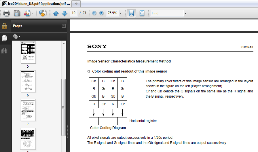

    Bayer pattern favors green with red and blue half sampled H and V as shown here.
    The DeBayer filter is probably optimized for RGB24 out. Suggest you check with Astronomy forums.

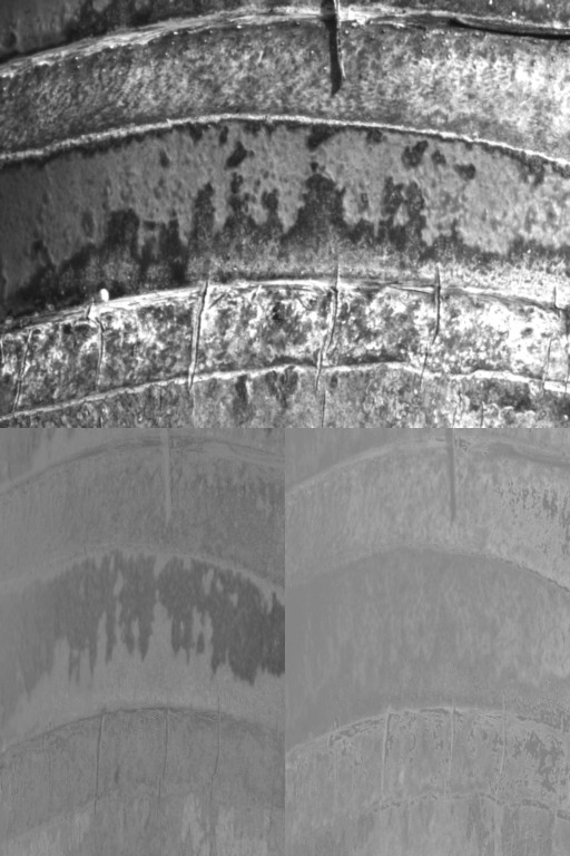

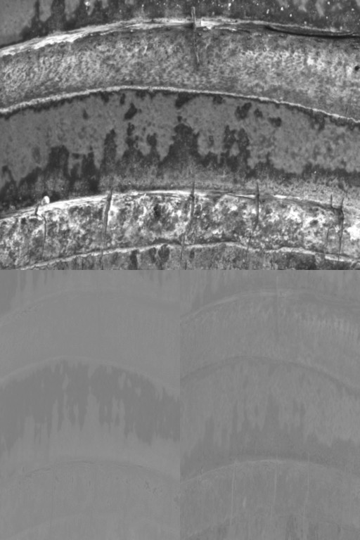

  9. Thanks for the Y800 sample. I understand it's a raw dump of the camera's sensor.
    Maybe you forgot to select Video -> Direct Stream Copy when you created the YUY2 sample? That would have converted it to uncompressed RGB24. The Y800 sample does appear to be Y800, not RGB24.
    Attached is your BY8 avi converted to YUY2. I made this in VirtualDub by opening the BY8 file, selecting Video -> Color Depth... -> Output Format To Compressor/Display -> 4:2:2 YCbCr (YUY2), then saving as a new AVI. If you compare this to the BY8 cap you'll see the differences are almost imperceptible. Ie, proper YUY2 shouldn't look much different from RGB. So something is going wrong in your software's YUY2 processing.

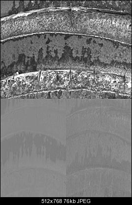

    YUY2 uses YUV instead of RGB to encode colors. Like RGB, YUV uses three components to encode color. The luma (Y) value is a grayscale image, U and V are the color components. YUY2 stores the color information at 1/2 the horizontal resolution of the grayscale information. So your 1024x768 image would have a 1024x768 Y channel and 512x768 U and V channels.
    If we take your BY8 cap, convert to YUY2, and separate the Y, U, and V components into separate images we get this (top = Y, bottom left = U, bottom right = V, all at half size):

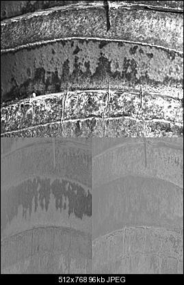

    Doing the same with your YUY2 sample:
    The latter has less contrast in the luma channel but even if we were to adjust for that the U and V channels don't look at all alike. Especially the U channel.

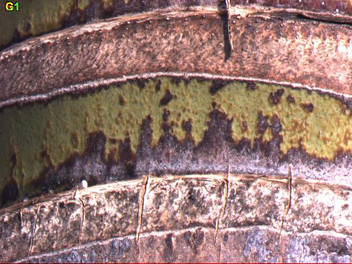

    I wrote a quick and dirty debayering function in AviSynth:
    AviSource("Y800.avi", pixel_type="RGB24")
    R=PointResize(512,384).Subtitle("R")
    Gr=Crop(1,0,-0,-0).AddBorders(0,0,1,0).PointResize(512,384).Subtit le("Gr")
    Gb=Crop(0,1,-0,-0).AddBorders(0,0,0,1).PointResize(512,384).Subtit le("Gb")
    B=Crop(1,1,-0,-0).AddBorders(0,0,1,1).PointResize(512,384).Subtit le("B")
    MergeRGB(R,Gr,B)
    And it delivered an image with colors very similar to your BY8 sample:

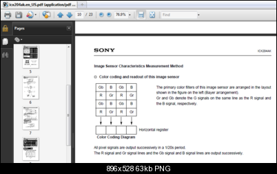

    Note that the layout of the data in the sample video differs slightly from that Sony document -- remove the top row of the bayer pattern example:
    The R at the top left now corresponds to the top left pixel in your Y800 video.
