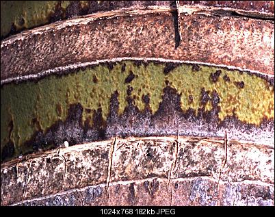

Page 2 of 2
FirstFirst 1 2
Results 31 to 41 of 41
  1. Originally Posted by 201flyer View Post
    1. I tried your alternate way and created RGB uncompressed. When I tried to run it through the Debayer filter I got the message that "input to filter must be YV12"
    Add ConvertToYV12() right after AviSource():
    AviSource("RGB.AVI")
    ConvertToYV12()
    FlipVertical()
    FlipHorizontal()
    DebayerFilter(swap=0)
    FlipHorizontal()
    2. Tried original method with actual Y800 capture .avi with dimension of 392 x 288. Error message "image pitch and width doesn't match"
    I couldn't reproduce that error message. But it looks like the debayer filter requires a mod 32 frame size (integer multiple of 32) to work properly. You would either have to add 24 or subtract 8 from the 392 pixel width with AddBorders(0,0,24,0) or Crop(0,0,-8,-0). If you AddBorders() you can crop that border away after debayering:
    AviSource("Y800.avi") #392x288 video
    ConvertToYV12() #if necessary
    FlipVertical()
    FlipHorizontal()
    FlipHorizontal()
    Crop(0,0,-24,0)
    Gavino mentioned this earlier in this thread:
    "At the end of the thread, there is a different plugin which does have source code.
    (See http://forum.doom9.org/showthread.ph...52#post1108152.)
    It gives you the choice of either bilinear or nearest neighbour interpolation - for a description of the parameters, see the top of source file demosaic.cpp."
    Is there any way to use this filter. I tried but failed. I just don't know enough about writing the script....
    You have to explicitly load the plugin at the start of the clip. Starting with his sample script:
    LoadCPlugin("C:\Program Files\AviSynth 2.5\plugins\demosaic.dll")
    ImageSource("image.jpg")
    ConvertToYV12()
    Demosaic(xoffset = 1, yoffset = 0, method = "bilinear")
    RGBAdjust(r=1.0, g=1.1, b=1.8, a=1.0, rb=0.0, gb=0.0, bb=0.0, ab=0.0, rg=1.00, gg=1.00, bg=1.00, ag=1.00, analyze=false)
    The script for your Y800.AVI:
    Demosaic(xoffset = 1, yoffset = 1, method = "bilinear")
    #RGBAdjust(r=1.0, g=1.1, b=1.8, a=1.0, rb=0.0, gb=0.0, bb=0.0, ab=0.0, rg=1.00, gg=1.00, bg=1.00, ag=1.00, analyze=false)
    Bilinear or Nearest Neighbor is slightly inferior to what the DeBayer() filter does. On the other hand Demosaic() gives you the ability to specify where the subpixels are located and doesn't require mod 32 frame sizes. The color adjustment he does after debayering appears to be correct(ish) for his sample image but adds a very blue cast to your Y800 video. I disabled the color adjustment in the above script to match the colors DeBayer() is delivering.

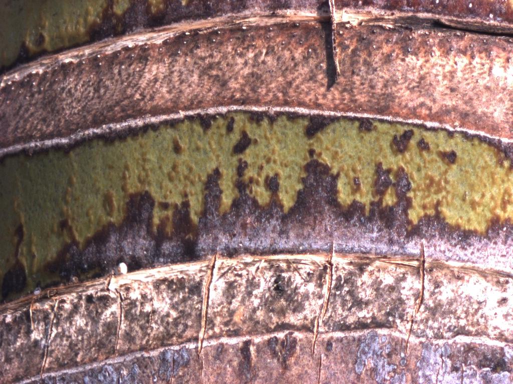

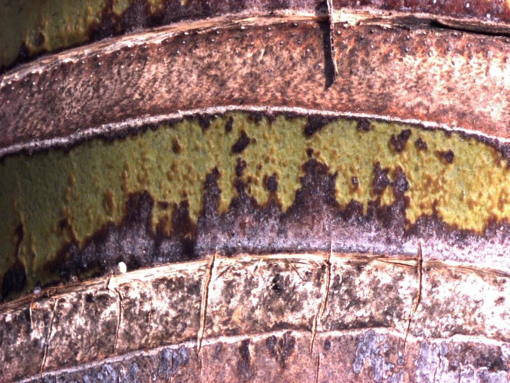

  9. Originally Posted by Gavino View Post
    The "Y" plane is raw RGB values, not YUV luma. The Debayer filter simply fills in the holes.
    You and I know that, but does VirtualDub know?
    It looks like you're right. Experimentally, VirtualDub is handling the Y800 data as Y and applying the usual rec.601 contrast expansion on conversion to RGB. AviSource("filename.avi", pixel_type="RGB32") doesn't apply the contrast expansion (although this may depend on the Y800 decoder that's being used).
    Opening the Y800 AVI file directly in VirtualDub and debayering:
    Using AviSource("y800.avi", pixel_type="RGB32") and debayering in VirtualDub:
