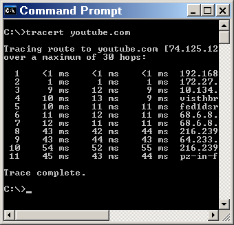

  11. As redwudz suggested earlier, run a tracert (trace route) to see how "far" youtube is from you. It will also show you the ping time to each intermediate routersL
    The idea of streaming video is to send it to you a little bit faster than the video is playing, not to send it as fast as possible. It looks like youtube shoots for about twice the bitrate of the video. But if they are very busy, or if some router between you and them is congested, or your internet connection isn't fast enough, you may not get the video as fast is necessary. And youtube has thousands of servers all over the world. So some videos may get to you faster than others.

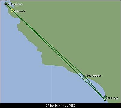

Size:  92.4 KBClick image for larger version
    Can someone decipher that for me, please? In any event, because of what pirej said, I feel better now

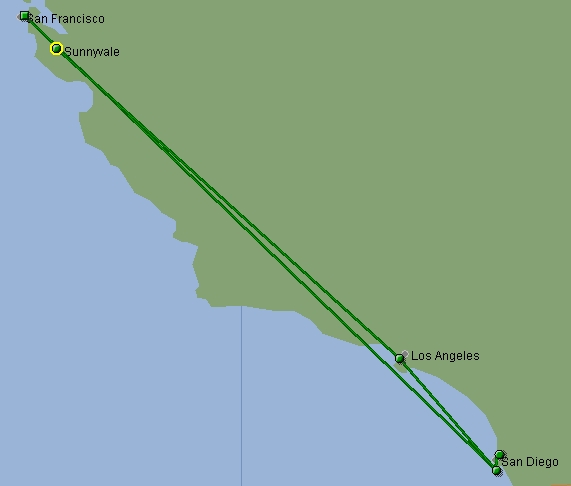

    Here's one without the timed out

    Ok, you dont have "timed out".. but you still have 2233 ms ?!?!!?
    I think you have some problem, maybe you should read this

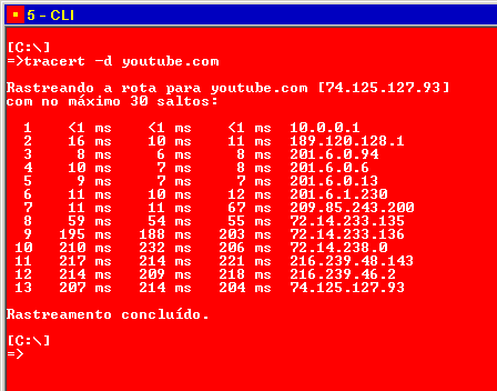

    I Even with a cräppy 1Mbps connection like mine,
    usually the playback of the YouTube videos is not interrupted.

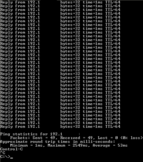

    Jagabo, here is the result of the ping test:

  18. Hop times are not the cause of your problems. Youtube is.
    I suspect your router is going into a low power state between runs of tracert since the long reponse appears to be on the very first ping. Try starting a continuous ping, then while that's running, run tracert. Do you still get the long hop time on the first try?

    I believe I know now what caused the huge number on the first ping. When I turned the Sygate firewall to "allow all", the first number shows only 9 ms. The huge number depends on how fast I can click "yes" to "allow." So, one mystery solved!
