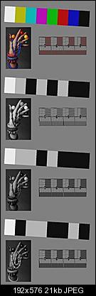

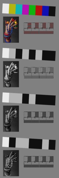

  5. This will show the primaries in color:
    Mpeg2Source("whatever.d2v")
    ConvertToRGB()
    R=RGBAdjust(g=-255, b=-255) #remove green and blue
    G=RGBAdjust(r=-255, b=-255) #remove red and blue
    B=RGBAdjust(r=-255, g=-255) #remove red and green
    StackVertical(last,R,G,B)
    This will show the primaries as grayscale:
    ConvertToRGB()
    R=ShowRed()
    G=ShowGreen()
    B=ShowBlue()

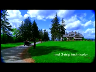

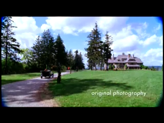

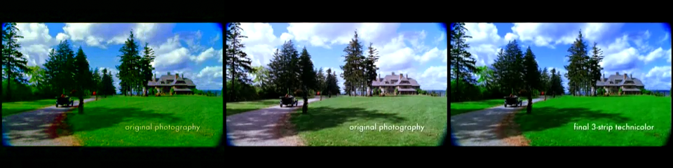

    More info here:
    http://aviatorvfx.com/?cmd=frontendOverview&id=color
    http://www.vfxtalk.com/forum/aviator-technicolour-process-t3515.html
    http://www.dailymotion.com/video/x3x99f_aviator-vfx-2strip-technicolor-proc_shortfilms
    The process could also be done using Blender's composite node system.
    IMO, the results approximate the Technicolor 'look', but don't look completely convincing.

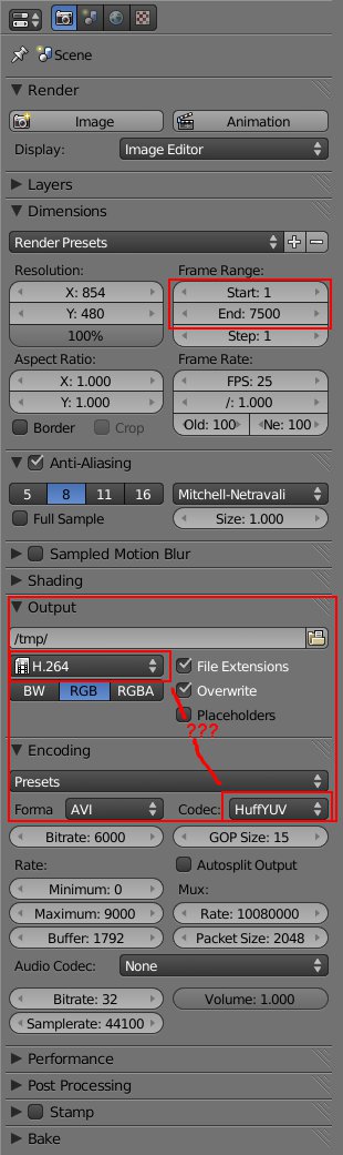

    @intracube - can blender render different sections of video into video simultaneously, or is it limited to exporting still image formats when doing that ?
    Oct 2010
    England

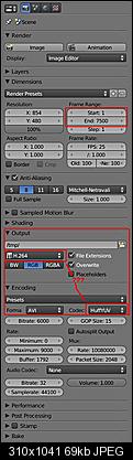

    As an example, if you had a short video (total running time 10 mins - 15,000 frames @ 25fps) in HuffYUV format:
    - open the video in the node compositor
    - arrange the nodes to produce the desired effect
    - on the 'render settings' dialogue, set the start frame to 1 and the end frame to 7,500
    - save the entire Blender project, and then kick off the rendering
    - simultaneously start a new instance of Blender, and load the file you've just saved
    - change the start frame to 7,501 and the end frame to 15,000
    - start the rendering project
    as long as you've set a suitable output format and codec in the Encoding box, you should end up with two videos that can be joined together.
    I've missed out a number of steps in that example - hope it makes sense. I'm also using Blender 2.56a.
    The Output/Encoding boxes are quite confusing - I don't think options like GOP size and Bitrate serve any purpose for codecs like HuffYUV. Also, the 'Encoding' options aren't even visible unless H.264, MPEG, OGG Theora or Xvid is selected in the 'Output' settings - and then there's an inconsistency if another codec like HuffYUV is selected (see screenshot). Also ISTR the resolution I've got set (854x480) might cause problems with huffyuv (not mod16?) ...but I digress.

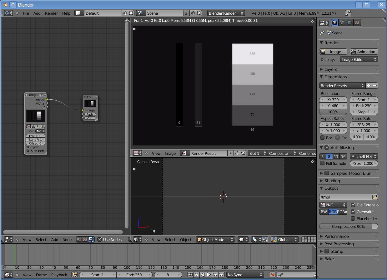

  23. ok i see, yes it wouldn't matter for huffyuv because it's I-frame only (and lossless if you use RGB +/- A out of blender), and you can join anywhere without issues
    now for some reason I thought you meant spawning multiple render engines within blender, even though you clearly said "multiple instances"... duh....
    does it's import engine use ffmpeg for video? Do you have much control over the RGB conversion on import?
    The problem with other compositors like AE, is that it will use a Rec601 conversion to RGB, so if you used that youtube video and imported directly as is, some of those cloud "superbrights" are clipped

    I think if you import NTSC .dv footage, the black level will look artificially high (pixel value of 16), and whites won't look fully white (235) on a standard computer display. I need to refresh my memory on the Rec. standards/colour spaces and run some tests.
  25. Member
    Oct 2010
    England
    Just to confirm:
    The testcard is from DVD Demystified.
    Additionally, none of the media players that I tried - ffplay,mplayer,xine (all on Linux), displayed the image correctly - they didn't expand the 16-235 range to 0-255.
    I don't know how the players determine if a video follows the Rec.601 spec. By analysing the resolution, framerate, header info?
  26. Is the "test card" an RGB image format, or actual YCbCr video (like .m2v or NTSC dv)?
    Most applications will assume Rec601 for YCbCr<=>RGB conversions. But for media players there are many more factors to consider, graphics card settings, overlay settings (if you're using a renderer that uses overlay), different renders have different output levels, monitor calibration. I would say there are dozens of different combinations that can potentially change what you "see"
    Some will do Rec601 conversion , but not necessarily clip Y' 0-15 and Y'236-255. They will keep the Y' values "accessible" when you use certain filters even when you work in RGB space. These filters are applied before RGB conversion so you can salvage that data range
    It's ripped directly from the DVD:
    General
    Complete name                    : stream.mpg
    Format                           : MPEG-PS
    File size                        : 668 KiB
    Duration                         : 33ms
    Overall bit rate                 : 166 Mbps
    Video
    Format                           : MPEG Video
    Format version                   : Version 2
    Format profile                   : Main@Main
    Format settings, BVOP            : No
    Format settings, Matrix          : Default
    Format settings, GOP             : N=1
    Duration                         : 33ms
    Bit rate mode                    : Constant
    Bit rate                         : 8 000 Kbps
    Width                            : 720 pixels
    Height                           : 480 pixels
    Display aspect ratio             : 4:3
    Frame rate                       : 29.970 fps
    Standard                         : NTSC
    Color space                      : YUV
    Chroma subsampling               : 4:2:0
    Bit depth                        : 8 bits
    Scan type                        : Progressive
    Scan order                       : Top Field First
    Bits/(Pixel*Frame)               : 0.772
    Stream size                      : 32.2 KiB (5%)
    Text
    Format                           : RLE
    Format/Info                      : Run-length encoding
    Blender couldn't open the file, so I converted it to .dv with ffmpeg:
    ffmpeg -i stream.mpg -target ntsc-dv stream.dv
    which worked with Blender.
    mplayer uses the XV overlay to display video:
    http://en.wikipedia.org/wiki/X_video_extension
    - "Similarly, the X video extension has the video controller perform color space conversions. It can also have the controller change contrast, brightness and hue of a displayed video stream."
    Although the XVideo extension is working, ^that doesn't appear to be happening
    That makes sense.
  28. Totem Movie Player is performing the usual 16-235 -> 0-255 YUV to RGB conversion on my Ubuntu system. I'm not sure about Linux, but under Windows almost all media players send YUV to the graphics card and it's the graphics card's responsibility to convert to RGB for display.
