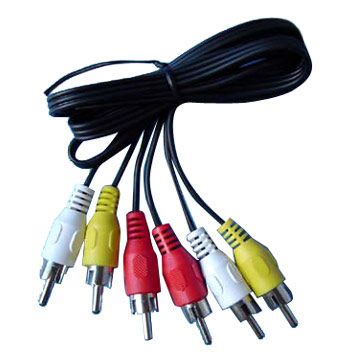

    So if i get an RGB scart converter and attach it to a RCA cable, i wil manage to have RGB signal, with best possible outcome?
    See i have a DVR-Station, where i attach my PMP (Personal MEdia Player), and i want to be able to output the best Analog Signal to an OLD TV. OLD TV's usually have RF,RCA,and Scart inputs.
    So if i get one of these with an RGB SCART HEAD on the TV end, i can get maximum results?
  8. Originally Posted by therock003 View Post
    No. Only composite video travels over an RCA cable. You need a player with RGB on the SCART output, and a TV that accepts RGB via it's SCART input.
