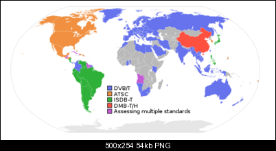

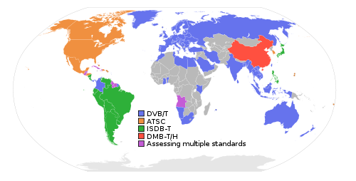

    Now we have the question refined. Quick answer is probably no.
    DVD recorder tuners vary by local markets. As already answered DVB models are not compatible with ATSC. But the question on cable QAM requires more research. In general, Europe uses a form of DVB with cable and sat, not 256QAM. There may be a country somewhere in the world that uses 29.97 fps analog NTSC and uses 256QAM with North American cable channel frequencies and has a better selection of DVD recorders. It wouldn't matter if the OTA tuner was DVB or ISDB-T.
    I'd start my search in South America in places where cable has converted to digital. Korea and the Philippines are also possible.
    http://en.wikipedia.org/wiki/Fileigital_broadcast_standards.svg
