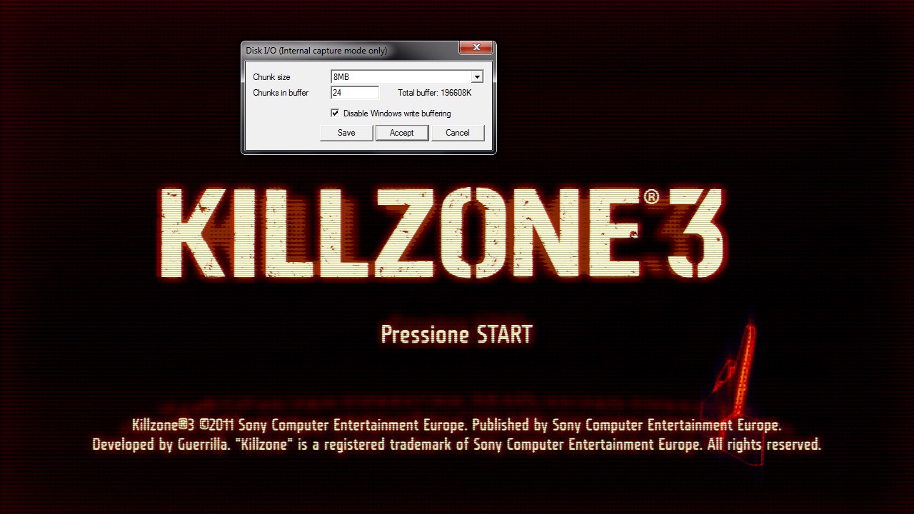

    For capture with AVERTV HD "0 frame dropped" on VDUB, setting DISK I/O look´s like the shot above:
    Record for 4hs+ and no have d-sync.
    Unfortunately you mention HD captures which I have not really been focused on, however I will try your settings myself when I get a chance.
    EDIT: I've gotten plenty of frame inserts using Test video capture (F7) and default Disk I/O. So I'm not sure if this test mode really removes I/O from the equation even though it doesn't truly write to disk. I can't find any documentation of what it actually does.
