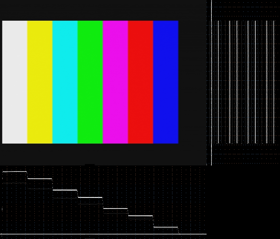

    AverTV HD
    + Correct levels
    + Correct vectorscope
    + Almost perfect solid colors over S-Video
    - Gain adjustment between scene changes is noticeably slower than the intensity pro, although 8 frames or less.
    - Needlessly oversharp, especially noticeable on the EIA 1954 test chart. No way to turn it off apparently as well.
    - Seems to easily freak out and drop frames once in a while, even from a pristine source.
    - ADC has more noticeable banding on gradients/histogram. Not very noticeable perceptually on normal video however.

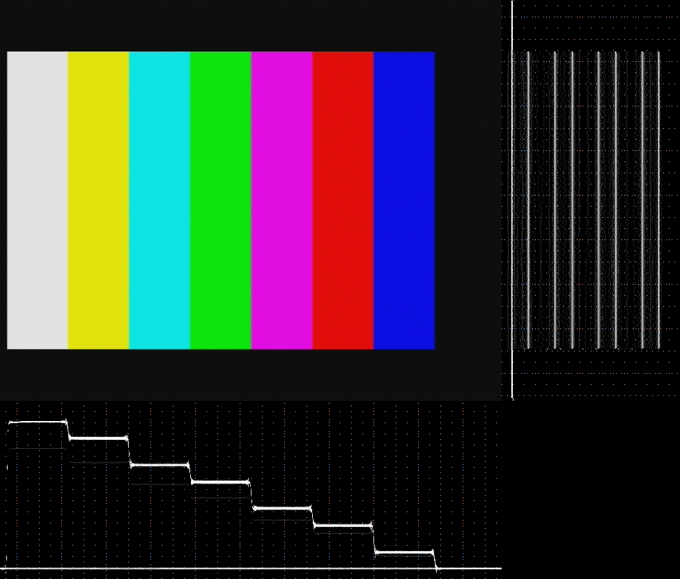

    Intensity Pro
    + Better scene changes for gain, maybe 1 or 2 frames lag.
    + No capture dropouts from a good source or straight from a crummy VHS
    + Sharpness is more in line and natural, and the EIA 1954 chart is GREAT.

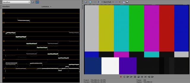

    - Levels are well over the top, even when I tried VCR input. Whites are well past IRE 100 outside of the colorbars for some scenes.
    - Very odd diagonal banding that is noticeable in both solid colors and in my VHS captures. This is also easy to see on the vectorscope with the tops having wavy lines.
    - I still get major desync problems on this card after an hour of capture

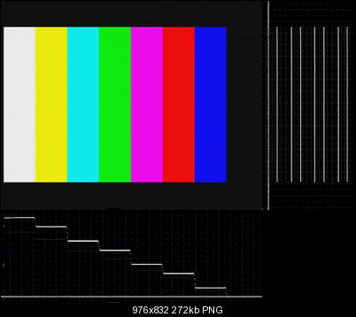

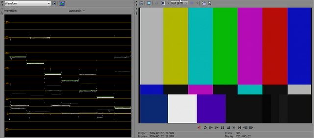

    Colorbars + Waveform AverTV HD
    Colorbars + Vectorscope AverTV HD
    Sharpness AverTV HD
    Colorbars + Waveform Blackmagic Intensity Pro
    Colorbars + Vectorscope Blackmagic Intensity Pro
    Sharpness Blackmagic Intensity Pro

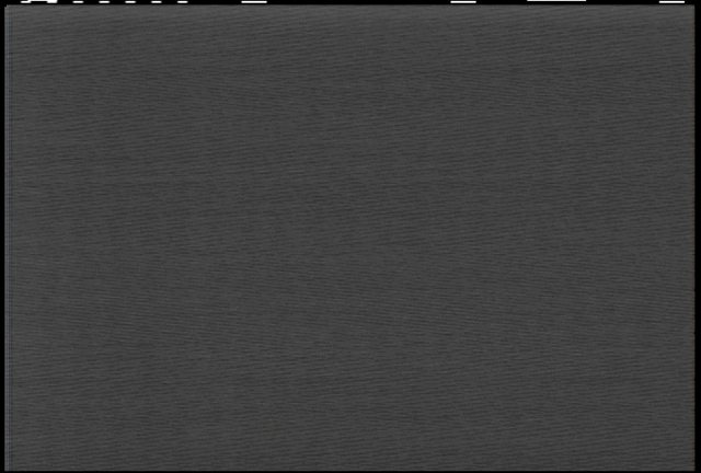

    This is an enhanced still of the Intensity Pro with a solid grey color. Makes the noise alot easier to see. The AverTV HD version is clean as a whistle compared to this.

  2. You left out an important bit of information. Which input on the cards did you use for these tests? Keep in mind that each input on the same card may vary. I'm actually surprised at how the Intensity Pro performs. As a "professional" level card, it should not have IRE or noise problems at all.
    I own the AVer card, and I can't say I have seen any problems with the over sharpening in my captures, or even AGC issues. They might not be noticeable with my home movie VHS captures (HuffYUV compressed), but of course it could vary by card as well. Remember that compression to MPEG-2 can soften the video a bit anyway. You could likely counteract the sharpness issue with a procamp or sharpness dial on the VCR if you have one.

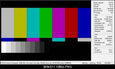

    Yeah I'm playing with it now as we speak. All A/V sync options are off and sending it a perfectly still image, about every 45 seconds it drops a frame. I can only imagine this is a fractional framerate issue with the card.
    If I disable "Try to adjust video timing for fewer dropped frames" I get dropped frames less often, but it still happens.
    The capture/preview pin are both set to 29.97 fps as well as virtualdubs capture rate. I'm not sure if its virtualdubs timing issue here or a missing decimal in the frame rate. The capture pin says "29.970" which makes me wonder internally if its timed to 29.97002 or something wonky like that. Unfortunately virtualdubs framerate wont go to that many decimal places... it says "29.9700" on its speed setting after I set the capture pin.
    Interestingly when test capturing raw video to eliminate compressor/disk issues, the average fps is 29.9776 or something like that until it drops a frame, then drops closer to 29.9700 but starts to creep slowly upwards again, as if the actual captured rate is > 29.97002. Clearly there is a fractional framerate issue at hand here. This one has me really confounded!
    I'll keep playing with it and let you know how it goes. I'll try disabling dropped/inserted frames, letting it go for a while, and see what it reports back as the avg fps/audio hz. It looks to me that the video capture driver is perhaps running a little too fast. I'll also try to compare it to my crap PVR-950Q USB (worthless for analogue capture, horrible AGC but maybe good as a 2nd opinion for timing) later.
    Edit: I'll try different drivers later as well too, perhaps it may be the ones I am using causing this issue. By the way thank you for the help on this issue ^^

    About wrong level with Intensity Pro. Here is a way to fix:
    http://www.etfinder.net/capturepics/
    Another card (Asus Pe6200) with wrong level:
    Both caps are from DVD player using the same cable (composite) and the same PCIe slot.

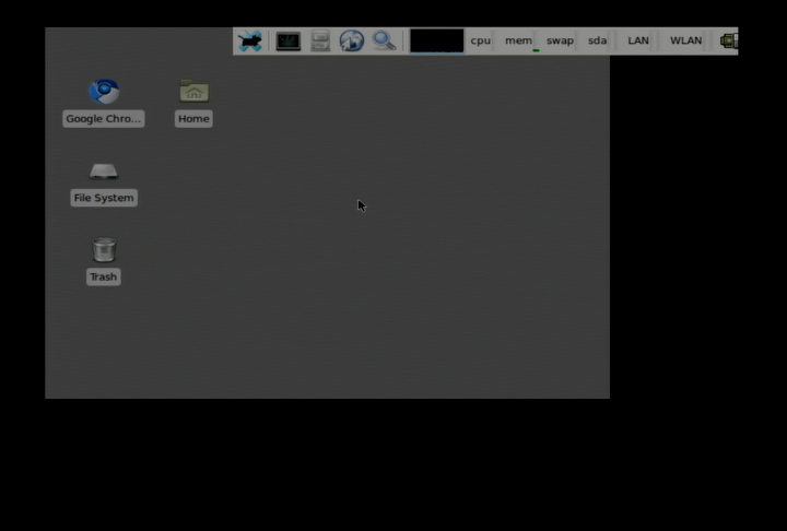

    Well here is what I get out of the Intensity as far as noise. Different computer, different mainboard, different cable, different source. The noise seems to be consistent still. It has to be part of the cards firmware or what it does.
    Here is a still using a spare laptop as video output, dark likely because of the poor s-video levels on the thing. Still, the noise is consistent with the other computer and captures. It's alot more noticeable in motion as it jumps all over the place, hence why I find it annoying.
    Auto adjusted levels...
    So uhhh... yeah :/ Unfortunately I could not make a animated gif that showed it in motion, it would not show up in it.

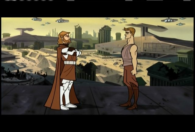

  15. In my experience with an Diamond ATI 650 USB 2, it's not just a few frames after a transition where the AGC has problems. Sometimes it goes on for several seconds. Sometimes it just blows out or crushes certain shots. And it's not just the luma channel that has AGC problems. You can see the same thing happening in the chroma channels (more/less saturation).
    https://forum.videohelp.com/threads/326560-Which-is-better-usb-stick-vhs-cap-or-hd-pvr-...=1#post2023227
    The AGC problems are unfortunate since the card is really great in other respects.

    Since I just took a peek at it before I have to go, it does seem that the Avermedia card is indeed running slightly too fast. I did an hour long test with both drop/insert frames unchecked, and the average framerate was 29.97843 (!)
    I put that into vdub, and then tried another capture with drop/insert back on. It took 5 minutes before it dropped a frame that time. Clearly its a speed issue.
    I'll try some older drivers later.

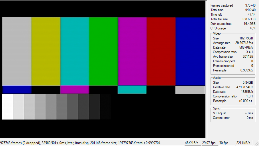

    Now that I got back to check it, the Intensity Pro captured 3+ hours of video using the laptop as a video source without desync problems. 29.97002 average fps, no dropped or inserted frames! Interesting! I'm trying the same with the AverTV HD as well just to see what happens there.
    Another check earlier confirmed the AverTV HD is running a bit too fast. 3+ hours of capture there and the average FPS was 29.98018. The video/audio is out of sync on playback, however if I tell virtualdub to "Set video framerate to match audio duration" under framerate the audio/video is in perfect sync, although the framerate is incorrect now.

  19. The slightly over the top levels on the Intensity Pro sample you posted doesn't seem like that big an issue to me. You can always pull it down a little in software afterwards. Are you getting peaks crushed at Y=255 with real world video? The levels in the cartoon cap looked fine.
    The noise is still a problem though. Maybe the card just isn't well designed and you're getting noise from the digital section bleeding into the analog section. The noise in the cartoon cap didn't look so bad. Certainly far less than VHS noise.

    Hmm sadly no better with the Intensity Pro 3.4 and 3.5.2 drivers.
    3.4 has clipped superwhite/superblack as well as being a bit off, the diagonal noise bars are noticeably worse than 3.9.4.
    3.5.2 has superwhite/superblack, and while being better than 3.9.4 its still off. Again, the noise bars are much worse than 3.9.4
    The reason I'm being a stickler about the noise bars is that they will likely throw any compressor for a loop and likely hurt compression quality.
    I'm going to say this card is a bust for now. Maybe the shuttle is built differently... this card is going back though

    I'm not sure how accurate the Average rate reported in the capture module is. The header for the file captured in the shot below was still written as 30000/1001. Sorry about the letterboxing; the remote for this DVD player appears to have stopped functioning so I can't access the Setup.
