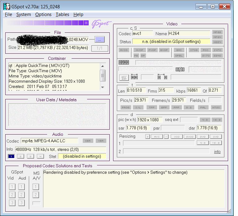

    I have that model camera. It is a 1080p camera. I don't have a saved clip to do a gspot screen shot of at the moment.
    It does 1080p, 720p60fps, 720p30fps and wvga (not sure on the exact resolution of that mode).
    I'll post a screen shot of the 1080p gspot file in a minute.
    [img]kodakzi.jpg[/img]
    Here is the screen shot. I don't know why it doesn't show progressive versus interlaced. Would mediainfo give that info?
    Edit - mediainfo doesn't show progressive info. Would mpchc show progressive?

  4. GSpot doesn't show much information about AVC video because it doesn't know how to parse the video. MediaInfo is a lot better in that respect. It shows the video is progressively encoded. And upon examination of individual frames, they are indeed progressive.
