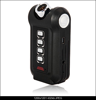

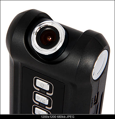

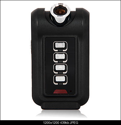

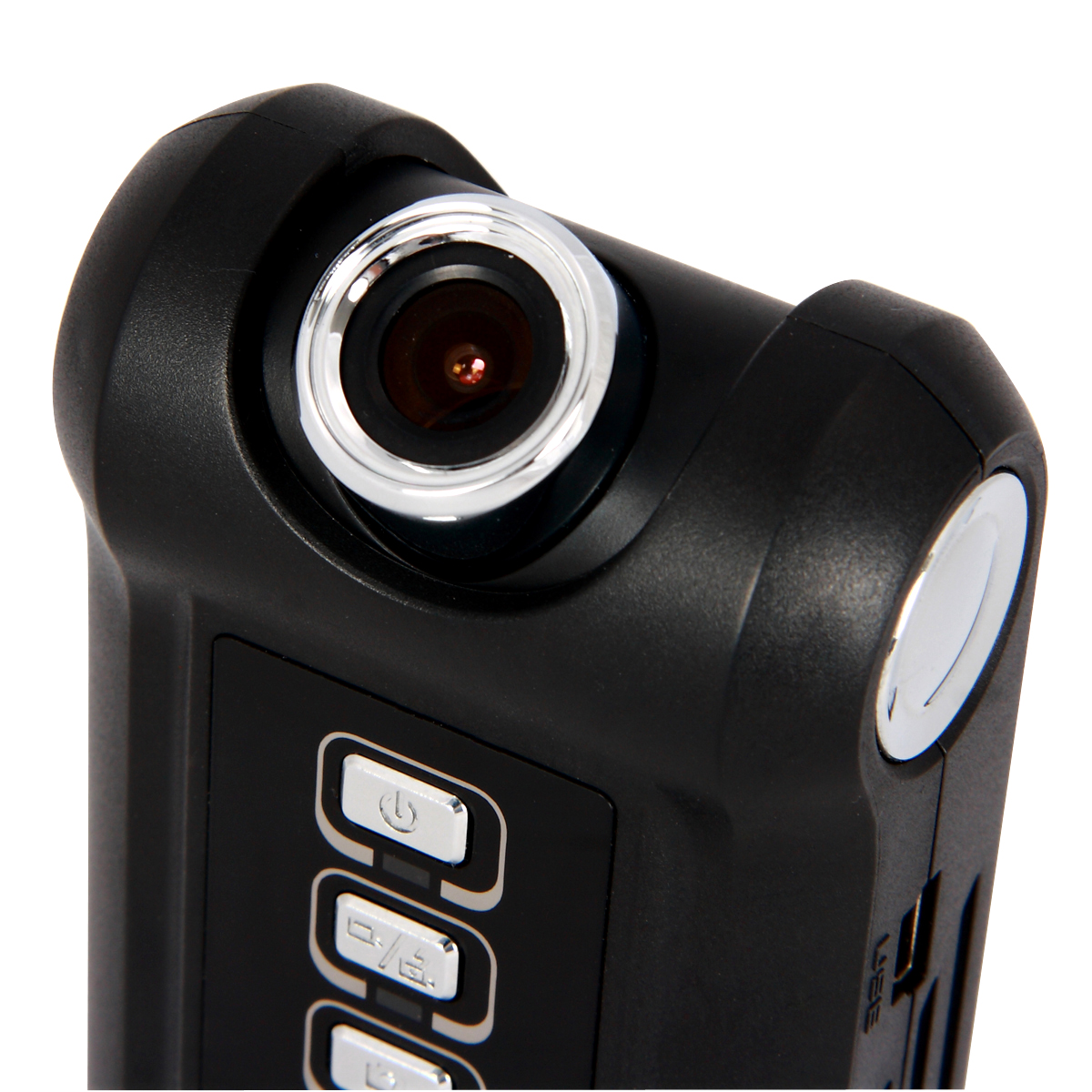

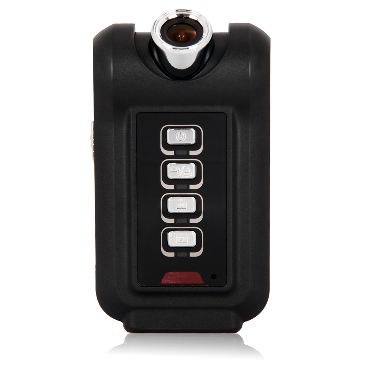

    yes i figured as much, came from china, trying to save a few bucks, i had already contacted buddie i bought it from on e bay and he jerked me around long enough that his warranty is done,,go figure,, no buttons anywhere on this camera for settings... i will post you a few manual pics,,kClick image for larger version
ID:	6005Click image for larger version
ID:	6003Click image for larger version
ID:	6006Click image for larger version
ID:	6007Click image for larger version
