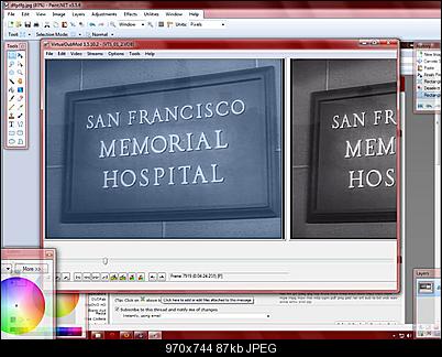

    Nov 2005

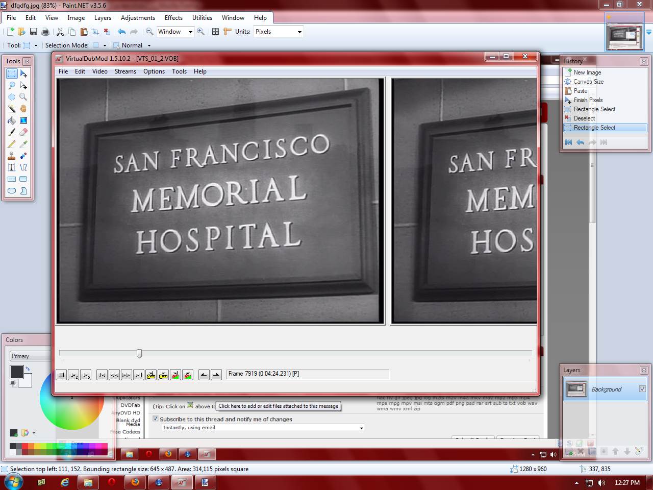

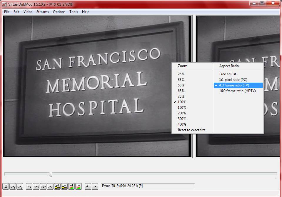

    i had the same issue...i would screen-shot with MPC or Vobblanker and the aspect ratio was wrong so i went the long way around to get it done right

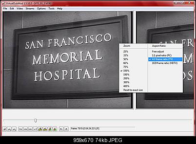

    opened the vob file in VirtualDubMod...right click on the screen and choose the right aspect ratio

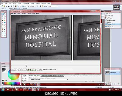

    hit the "print-screen" button on your keyboard
    open up an image editor..i use paint.net..paste the image in

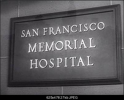

    ..then crop the part of the image you just print screened and voila
