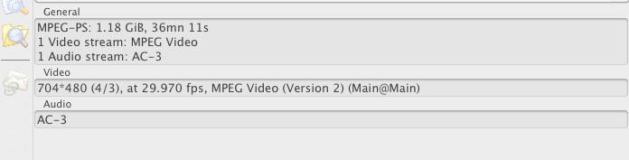

    Ok so I attached a mediainfo screen shot. Hopefully i can provide some clarity. Also, there IS a txt file in the same folder in the following format: MYVIDEO.mpg and MYVIDEO.mpg.txt

    Okay that's a normal mpeg file with ac3 audio. If you delete that text file vlc will not give you that error.
    Don't know why mpegstreamclip wouldn't work with the file correctly because that's a normal looking file.
    Avidemux should open the mpeg though.
