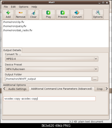

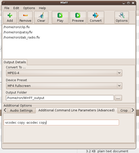

    Hi
    If I had flv files that were x264/aac I would use Winff to do the job in one pass.
    It would be equivalent to using ffmpeg like this:-
    ffmpeg -i foo.flv -vcodec copy -acodec copy foo.mp4
    So I'd choose the Winff options:-
    Convert To... MPEG-4
    Device Preset... MP4 Fullscreen
    And in the 'Additional Options' section type in the 'Additional Command Line Parameters' box:-
    Other converter programs such as MediaCoder have options to 'Copy' video and audio in the codecs section.
    So would this be a multiplexing job and not a reencode?
    As long as its simply putting it in a new container thats what I'm looking to do.
    Is there a batch mode for these programs? I must admit I've never used winff or mediacoder so I don't have any experience with them.
    So long as they simply take a flv with h264 and spit out a mp4 file that the wdtv will read that is what I want. Will it take the flv directly then without demuxing? That would simplify the process and as I mentioned if it has batch processing that it'd be great to set it up and let it run.
    Thanks bat999 and i'll give it a try.
    Edit - Thanks that worked perfectly!
    Its a lot more streamlined and nicer than doing flvextractor and mp4muxer thats for sure. It took the flv directly and after I put in your settings you described it outputted the mp4 in practically no time (45minute 225mb flv file fyi).
    I tested it on the ps3 and worked like a charm. I also tested it on the wdtv media player gen 1 and worked perfectly. Again it did not work on the xbox 360 for some strange reason. That is inconsequential as I have two devices that will work with it just fine.
    Thanks bat999 that did the trick. Now I'll check out winff's batch capabilities if it has any. That should speed this process up considerably.
