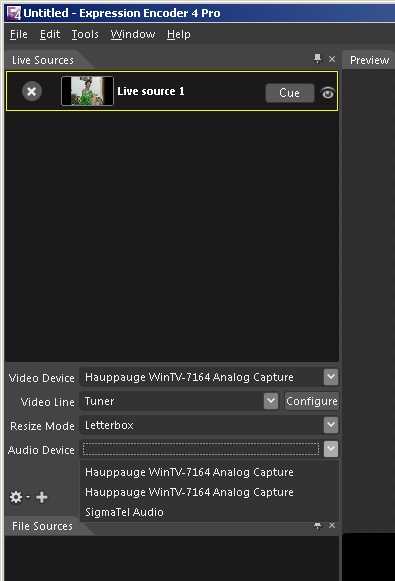

    I am using a Hauppage WinTV HVR 2210 (PCIe) that has a single line input that takes a tv signal. I can record and playback using both WinTV 7 and Windows Expressions Encoder. In Windows Expressions Encoder, I set the "audio device" to the TV tuner card - i.e. Hauppage and not to my Sound card, Sigmatel (although I can see both options). See below:

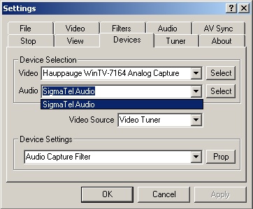

    However, when I use Virtual VCR, the video device selection shows the Hauppage card, but the audio device selection ONLY shows the Sound card, Sigmatel. Using the audio device as Sigmatel does not work in Virtual VCR and neither does it work in Expressions Encoder. This results in no audio in Virtual VCR. See Image below:

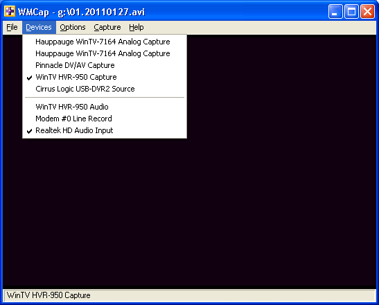

    in my system, i am using its built-in audio since it is enough for my needs, the audio brand is Realtek.
    1. to capture video with audio, you must connect the [a/v source device]'s audio to the input connector of the audio in your system's motherboard. if you are using an external pci or usb audio card and it is the active audio device in your system (device manager) then use that as the input connector.
    2. in the capture software setup or configuration box, set the audio to that device. in my case, i set it to the [Realtek HD Audio Input]. in yours, you may need to set it to the [SegmaTel Audio] input.
    in your example screen shot, it seems virtualvcr is auto-configure to the correct audio device, your SegmaTel.
    in the wintv 7 screen shot, you should set it to the SegmaTel as well.

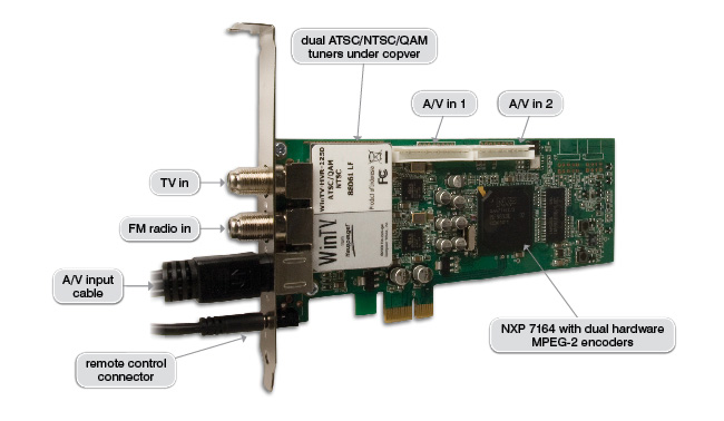

    Below is a snapshot of my card:
    Are you saying I need a cable that goes from A/V1 or A/V2 to the motherboard?

    This card have internal audio ADC (soundcard). No cable between card and motherboard is required. The sound is sent over PCIe interface. AV1 and AV2 is for external composite and S-Video inputs, are two because is dual tuner. Two analog inputs can be converted in the same time.
