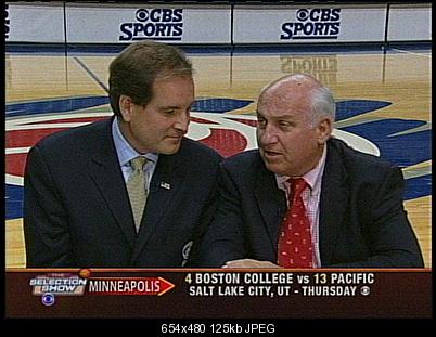

    This is normal because NTSC 4:3 video translates to 704x480. If you capture 720x480 you will get 8 extra black pixels left and right. You are getting an approx 2 pixel picture shift to the right that is not normal.
    Digital DV camcorders and commercial DVDs record extra width out to 720.
    Example: 704x480 NTSC captured as 720x480
