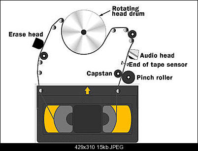

    The large piece looks like the rubber pinch roller ... that piece is what actually pulls the tape across the VCR Head at an accurate speed.
    The other two spindles ... provide ... FF and RW and to take up the tape within side the tape cartridge.
    The rubber wheel ... seen loose on your table ... pinches the tape against a metal shaft ... the metal shaft is attached down below ... where it cant be seen .... there will be a large flywheel as part of the metal capstan shaft ... to smooth the speed and keep the tape being pulled across the head at a accurate speed.
    I would say ... some small metal clips are used to retain the parts ... and they have somehow become ... not attached and perhaps ... lost.
    Oct 2005
    666th portal
    i'd agree with lacy. the capstan and pinch roller assemblies appear to be missing from inside your vcr. not likely you will be able to fix it.
