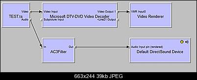

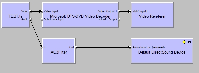

  10. I tested graphstudio and what bothers me a bit that it shows "Microsoft DTV-DVD" as the decoder (latest ffshow is installed).
    See attachement
  11. on win7 you need preferred filter tweaker
    right click the 1st box, are you using haali splitter or some other splitter ?
  12. Does changing to ffdshow with the tool listed above help ?

  15. Originally Posted by poisondeathray View Post
    Again thanks for that tip, now it works.
  16. so it was microsofts fault ?
