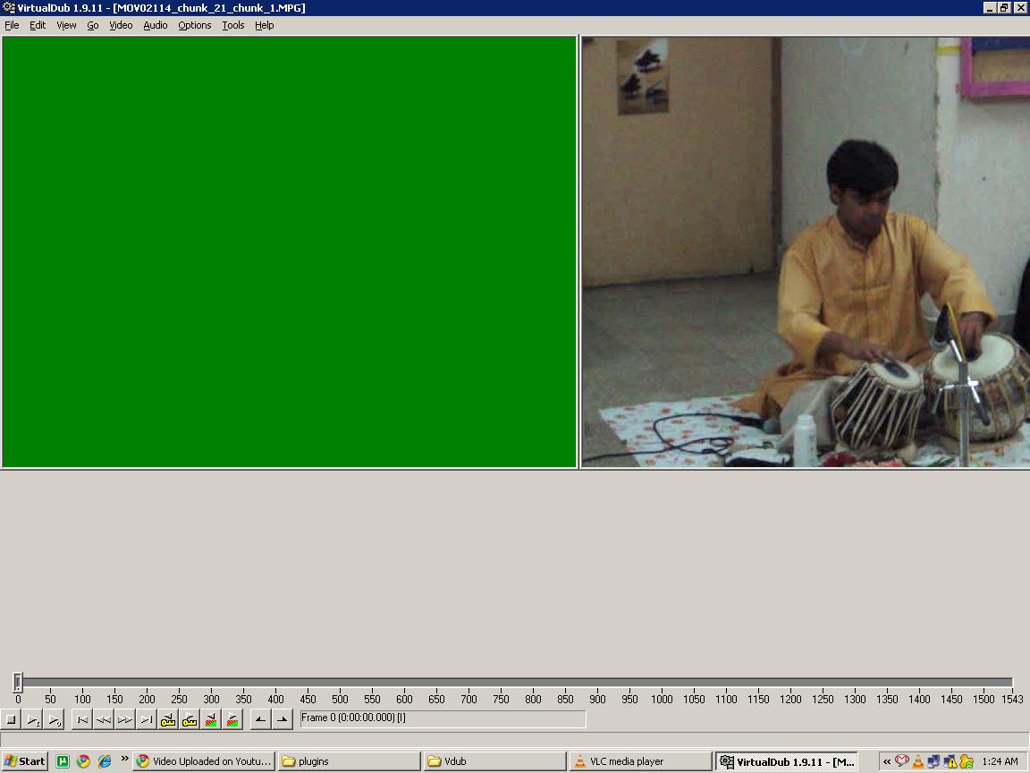

  13. Okay here's the screenshot. The green screen actually contains the input video, but for some reason it hasn't been captured by print screen. The output screen is the one that goes black and gives the error message.

  14. If I uncheck Deshaker (it hasn't even finished the first pass yet), I get this screen with both input and video screens visible. The input screen is still green, my print screen doesn't seem interested in capturing it.

  15. VirtualDub is using Video Overlay mode to display the source video (because it's more efficient). That uses the graphics card's ability to handle video -- the video isn't really on the Desktop. The green window you see from the screen cap is a hole in the Desktop through which the graphics card displays the video. If you need to make screen caps you can force VirtualDub to use the Desktop to display both panes. Disable: Options -> Preferences -> Display -> Use DirectX for Display Panes. You'll probably have to exit and restart VirtualDub for the change to take place.
  16. I could do that but the main issue here is the "No previous frame to match on" and a black output screen the moment I check Deshaker.

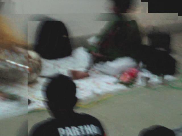

  17. I am getting a weird output. I cut a small segment of the main file and only applied the Deshake filter. Did everything like you mentioned and then saved it as Xvid in an AVI container. The resulting output video is rather funny and I am attaching it here. Can you take a look and tell me what's going on? I have got everything figured out; it's only when I apply Deshake that things go haywire.
  18. I forgot to mention that I enabled the "Use previous and future frames to fill in borders". To deshake a video it has to shift each frame around to keep the subject centered, leaving the edges of the frame are empty. That option lets deshaker use parts of earlier and later frames to fill in those empty areas. It usually works pretty well with static backgrounds. You can also try some of the other edge compensation methods, like adaptive zoom.
  19. Do I need to make any changes in the settings under "Use previous and future frames to fill in borders"? Or should I just keep them at default? In the edge compensation drop-down menu there are four option that feature adaptive zoom, which one do you recommend?
  20. I used the defaults for the border fill options. I recommend you try the edge compensation settings your self and see how they work. Your video is very shaky and has a lot of motion blur during the shakes. You probably want to minimize the zooming.

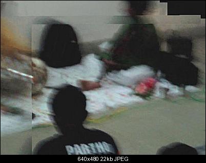

    I don't know what you mean by "fading in and out". Are you talking about the errors at the edge of the frame (where deshaker didn't perfectly match the background)? Like this:
    You might try widening Previous Frames and Future Frames values. And Soft Borders will soften the edge transitions. Increasing the Motion Smoothness settings might help too.
