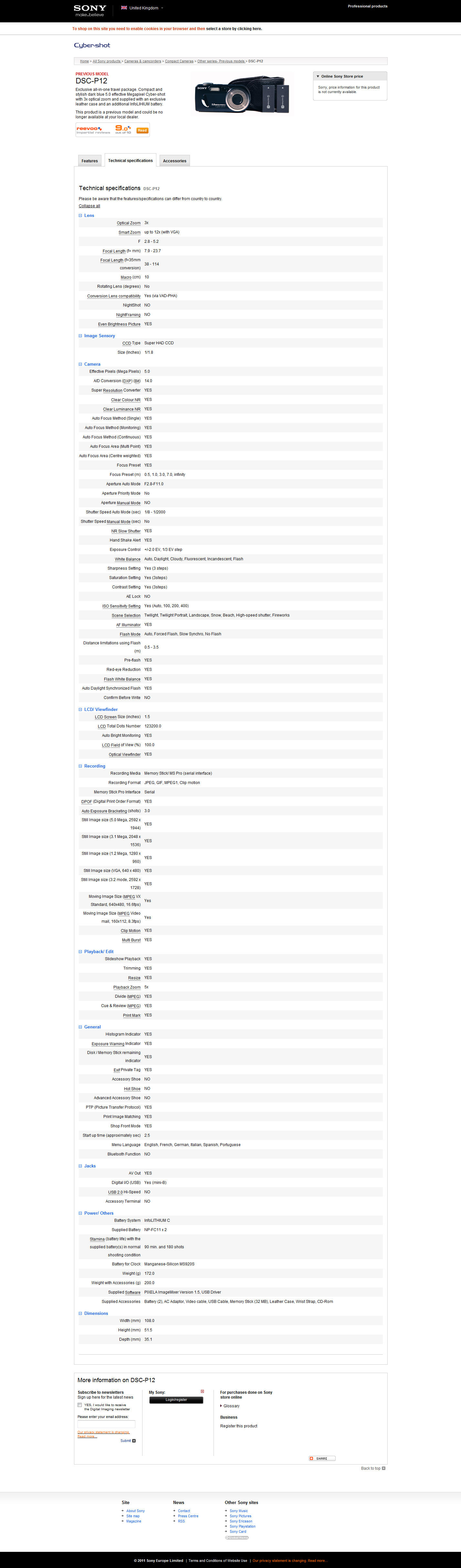

    ok so it's a still cam shooting video. does the video start off with the posted specs?
    Video Capture: MPEG - 640 x 480 - 16 fps
    somewhere along the line it got converted to 25fps. i thought it might be playing a bit fast.

    i looked up the camera specs and that's what is listed for the video output. 16.6fps. it might explain the duplicated frames in the video. are you copying the file straight off of the memory card as in copy/paste to the hard drive.

  8. So, if it outputs at 16.6 fps, why does the file show 25 fps in mediainfo?

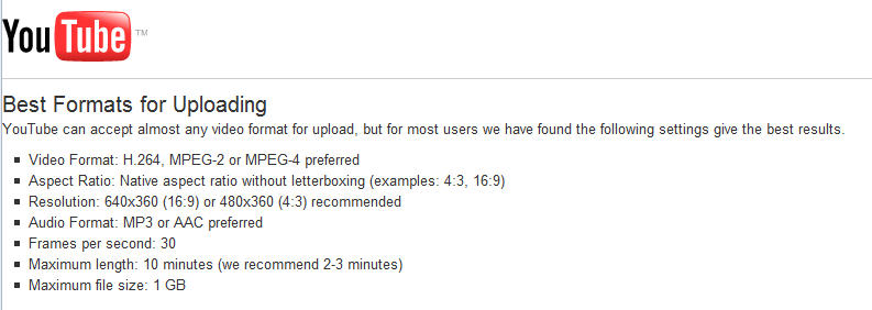

    mp4 is the best available for uploading to youtube. youtube re-encodes everything so there is always some video quality loss. try raising the bitrate to quality 100 and uncheck multipass.
    as for the framerate - you got me? it looks like it records at 16.6fps from the sensor but writes the video file at 25fps by inserting duplicate frames. it wasn't meant to be much of a video cam. sorry.

    from the horses mouth.
    they would prefer mp4.

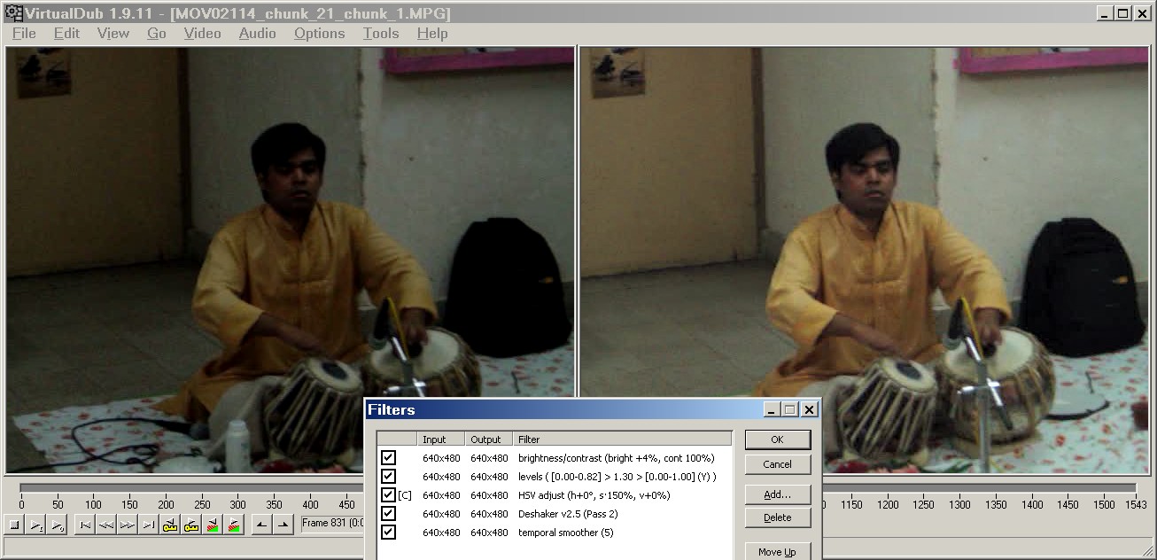

    Yes, that's exactly what I'm suggesting. For the third time I'm saying your black levels are crushed and the video is way too dark and murky.

  26. I used a combination of AviSynth and VirtualDub. But you can do all of it in VirtualDub:
    You can use the Video -> Frame Rate... dialog to fix the frame rate.

  27. A couple of problems: (I am using VirtualDub 1.9.11 -- stable, 32 bit, x86 version)
    1) I can't find "Deshaker" in the Filters menu.
    2) In your image, you have a [C] at the beginning of HSV adjust. Can you tell me how to get that?
    3) How do I export to mp4? I checked Video --> Compression. H264 is not listed there.
    4) I went to Video --> Frame Rate. Out here there are two options --> a) Source Rate Adjustment and b) Frame Rate conversion
    a) I have selected --> Change so video and audio durations match
    b) I don't know if I need to change anything here or retain the default which is --> "Process all frames"
    5) I think you have left the audio compression untouched and the way to do that would be to select "Direct Stream Copy" under Audio. Is

  28. Deshaker doesn't come with VirtualDub. It's a third party filter:
    http://www.guthspot.se/video/deshaker.htm
    VirtualDub doesn't support exporting to MP4 directly. You'll need an export plugin for that.
    https://forum.videohelp.com/threads/331131-ts-mkv-do-I-need-tsMuxer-mkvMerge-or-vDub-is...=1#post2051766
    For Youtube uploads you can just use Xvid in an AVI container though.
    For the frame rate change you want to use the "Source Rate Adjustment" section. Tick "Change Framerate to:" and enter 16.67. That tells VirtualDub to ignore the frame rate indicated in the source file and just assume it's 16.67. Don't change anything else.
    Deshaker is a little tricky to use. You must set it to Pass 1 and run an analysis pass (File -> Run Video Analysis Pass). Then go back and set it to Pass 2 and you're ready to go. When I processed your video I turned off Detect Zoom. And I set the Horizontal Panning, Vertical Panning, and Rotation values to 5000. Everything else was left at the defaults.
    You can adjust the audio skew via Audio -> Interleaving... set Delay Audio Track to the required value (milliseconds) to a positive value to delay the audio, a negative value to advance the audio.
    When you open your MPG file tick the "Ask for extended options..." option in the File Open dialog. One of the options is "Allow direct stream copy of mpeg audio".

    Also, in your image, you have a [C] at the beginning of HSV adjust. Can you tell me how to get that?
