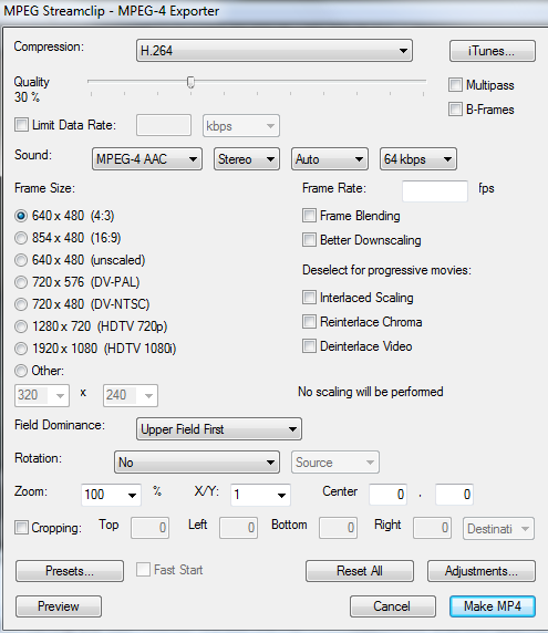

    by using mpegstreamclip i was able to get past it and convert to mpeg-4/aac which youtube will use properly. try converting the entire video with it. ( file export as mp4.)

  16. Ok, this looks great. The quality of the mp4 is a tad lower than the original mpeg though. Wondering if it makes sense to try and improve on that since Youtube will probably ruin the video a bit anyway.
    I tried doing what you said using Avidemux, but it didn't work out. So I am now trying to figure out Mpeg Streamclip 1.2.
    This is what I think I need to do :
    Go to --> Export to Other Formats
    Select MPEG-4 as the compression
    Click on Options
    Now here there are many fields that need to be filled, and I am not sure if I am filling them out correctly. Could you please post what settings you used here?

    sure and i used a lower than normal bitrate to make it small to upload here. you can use a higher one for better quality. move the quality slider to 50 to start and see if it is good enough for you. in the picture i forgot to enter 25 into the framerate box, you should do so.

  19. Thanks a lot. This actually works. YouTube handled the mp4 very well. I am tempted to keep the quality 100%. Why stop short? As for the Audio, should I keep it at 256 kbps? That's a little counter-intuitive since the source is at 64 kbps.
    Actually I made the mp4 differently than you have. Instead of exporting to Mpeg-4, I exported to "other format" and there I selected Mpeg-4. I also went into the options where I changed things like the resolution, H.264, frame rate. But there I couldn't change the "data rate" to more than 256 kbps or Quality more than 50%.
    I got a 37 Meg file which looks kinda okay. I am wondering if this would be one good way to do it or will your method and making the quality 100 % will give me a better output?
    Also, how did you come to know that there is an error in the source at 1:01?
    And, there is another option -- MP4 Advanced Video Settings where I have two encoding options -- Multi-pass and single pass. It seems to make more sense to go for Multi-Pass. What do you recommend?

    i rest the aac audio bitrate to 64kbps, no reason to make it more. the mpeg-4 exporter is just easier to set up, but i would leave the size 640x480 alone, as it will retain better quality if it isn't re-sized also. try both and see what you like.
    most encoders i tried died just after a minute into the video and mediacoder reported the error.
  21. Originally Posted by aedipuss View Post
    Yeah, but you made it dual mono so that same bitrate is now spread among 2 channels. If he's going to make his dual mono, he should up it to at least 128. Yeah, I know AAC audio compresses better than does MP2 audio, but still... And I ask again, why is every third frame of yours a duplicate frame?
