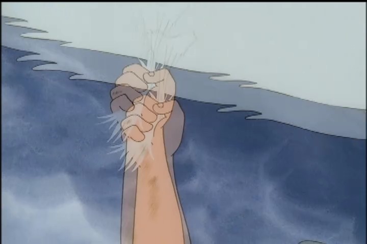

    i will use blends filters but i have problem with some parts

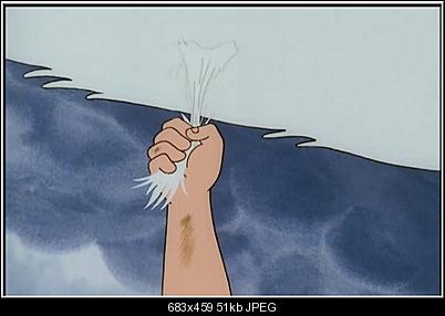

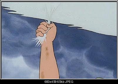

    of the video look at the image below:
    Original image:
    Blend image:
    Sample file:
    http://www.multiupload.com/XZLX6ONFNC

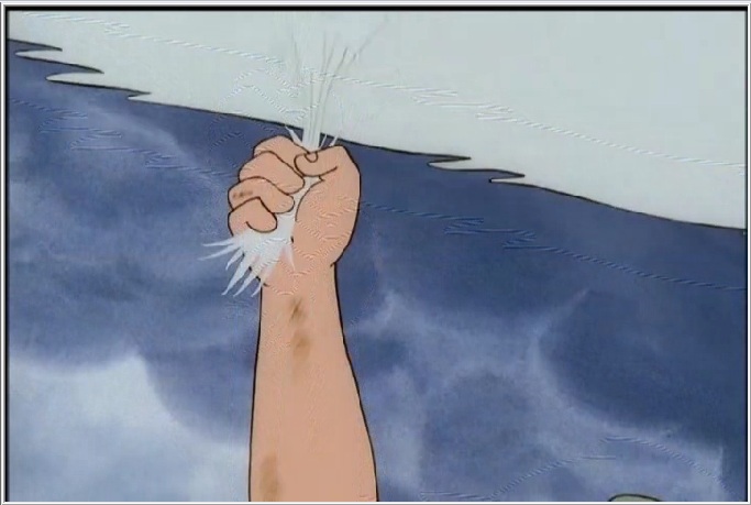

  14. Not the same frames. And is that at a scene change?
    Deblenders aren't perfect anyway. Sometimes the source is too messed up.

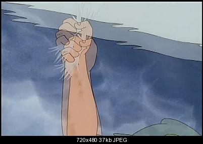

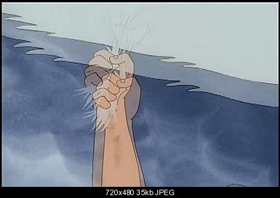

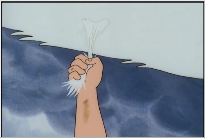

  15. Those are artifacts from imperfect deblending (and from compression artifacts in the MKV source). I don't think there's anything you can do about them. It's certainly less annoying than the two blended frames in the source:

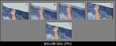

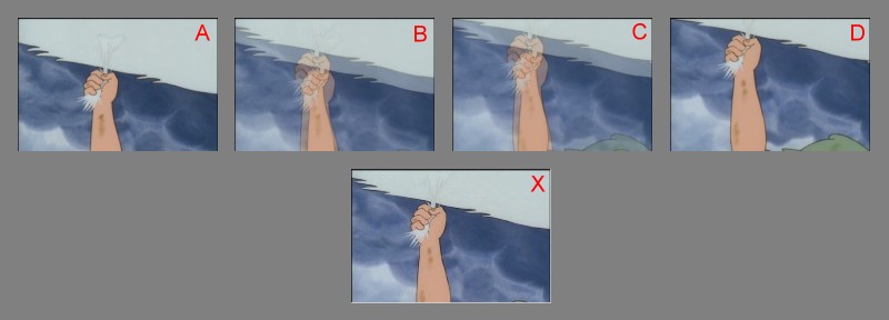

  19. Because of the way the MKV file was made some of the original film frames appear only as 50/50 blends with the frames before and after:
    The top row is a sequence of 4 frames (A, B, C, D) from the MKV file. Between the original film frames A and D there was a frame X. That frame doesn't appear on its own within the MKV file so SRestore() had to reconstruct it by subtracting half of frame A from frame B, subtracting half of frame D from frame C, then adding those two together.
    The artifacts in frame X are partly because the original video contained only fields, not full frames, and because of artifacts of h.264 compression used in the MKV file.
