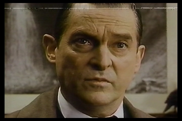

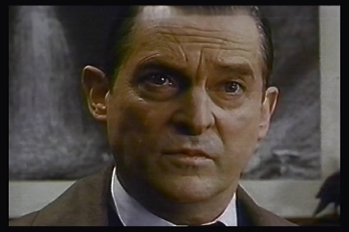

    Here is my try:
    - color correction made in vdub/avisynth
    - defects cleansing in pfclean
    Note:
    The result could be better because i haven't used a deflicker filter or noise reduction (neat), the idea was the keep as much details as possible here.
    video comparison (x264/mkv):

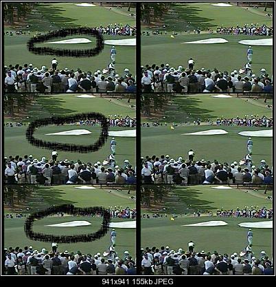

    In this next post, I am going to show three frames. This is only a small problem but you can clearly see it in the video.
    What happens is the video rip & tears around the bunker by the green, you can see this in the area that is circled. (I know it is hard to see, had to reduce the size of the picture to put 6 frames in it)
    Put the video on your 46' TV and you can clearly see it......
    Because this camera angle is not moving, it is kind of an easy fix. We find a good frame, and than cut out the entire bunker area. The key to doing this correct is to break down the pixel to the smallest level, than in the same spot, in the damaged frame, replace that segment.
    (If you are not good at matching up the segment or you are off by just a pixel, you can usually see it in the video, than you just have to go back and re-do it)
    Sounds easy enough, I don't use photoshop never liked it, use corel paint shop pro...
    Now taking a film frame and replacing it with a .bmp file, this is VHS or Betamax so you really can't tell the difference, unless you save to something that is really lossy and you get a color shift.
    If you have a lot of these problems is were the work gets to be too much, but something simple, takes only a few minutes to fix.
    (The hardest part is finding the flaws in the video, this one is only three frames)
    This is my method, what I do is load the video up on my laptop, which has a pretty nice screen.
    Take the Demo Video and plug the hard drive in to the TV, than watch it, than when I find an error, just go to the PC, find the frame and try to fix it. It is a PAIN to do, however before I was just cutting the video and being done with it. This way I can find all the damaged frames. It really depends how important the recording is. This picture below is from the 94 Masters, with a pretty good picture, it is not like you can go an watch the full coverage again, it is kind of rare.

  21. I'd need a video sample to tell you
  22. Banned
    New York, US
    What do you do if there's motion?
    This is much easier in Photoshop. I don't know what you mean by judging the position of the area you want. Every image had x,y coordinates that you can use to determine pixel positions.
    Definitely.
    Take the Demo Video and plug the hard drive in to the TV, than watch it, than when I find an error, just go to the PC, find the frame and try to fix it. . . .It is a PAIN to do. . .
    I'd agree, it's indeed a pain, and the hard way of doing it. I don't know why you have such a problem seeing flaws on anything except your 46" TV. If your basic PC monitor is a laptop screen, you need to plug your laptop's video output into a calibrated PC monitor so you can more easily what's happening.
    There are easier ways to do all this. Here is the method I use to replace spots and other damage in Avisynth. This is a method I often use after I've run a script or two to fix as much as possible before trying to clear the "remnants". In fact, this whole thread contains many tips and tricks that don't cost $$$ or as much time and/or trouble that you describe:
    https://forum.videohelp.com/threads/342085-I-think-an-easy-way-to-fix-dots-flickering-%...=1#post2133738
    Here is a sample of repairing some bad floating line/spurious responses from frames. Other parts of the thread discuss handling some serious color problems, as well. The "problem" sample is posted here:
    https://forum.videohelp.com/threads/343296-Transfer-of-real-bad-tape-to-pc-and-restore?...=1#post2139140
    A method of repairing it (with sample) is shown here:
    https://forum.videohelp.com/threads/343296-Transfer-of-real-bad-tape-to-pc-and-restore?...=1#post2139402

    This short clip is why you can't always trust the X,Y Plotting. This picture rip, has movement in it. Again it is something that most people would let slide. It is only like 2 frames....
    I don't know how to fix this in software, and maybe there is an script that would fix this problem, it doesn't take that long to repaint these two frames. Creating this video and typing this message took longer. The repairs are acceptable, it gets rid of the flicker from the tear. Yea it could be better but whatever.
    The 1st segment is the video fixed, 2nd segment is the damage, 3rd segment is the damage slowed down to 1/4 speed.
    This is just the project that I am working on, tomorrow it can be something else.
    Edit: Just watched this video a few times, a saw a few things that could have helped blend the pictures a tad better. You don't always get things correct the 1st time. Now I go back and re-work those frames to try to get it to blend better. If I don't think it is going to be a big deal, will just leave it as is. Just feel that my blending has a slight skip in it, just want to smooth it out, so you can't tell that the video was damaged, right now you can.
  25. Originally Posted by Deter View Post
    The reason why it doesn't match is you're working in frames, not fields - you've deinterlaced the repair frames
    For interlaced video, you should work in grouped odd/even fields, then re-weave the fields - that way you preserve the interlacing
    This is a rather tiny "blip", and you're right it's easy to paint 2 fields - but can you imagine many defects on multiple fields?
    That's what some of the suggestions above address - workflow tips to speed up repairs. You can often combine the techniques for even faster & better results
    On large repairs, or very damaged frames, interpolating fields or frames can save you many hours of painting
    Motion tracking can save you many hours as well , instead of manually going frame by frame
