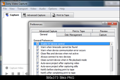

    I use the capture program with my Vegas Pro and like it but I have a question for those that know anything about it. I have never had the problem I am going to explain until a week ago. Well, when I go into the capture I get it all set up and ready to go. I hit capture but then it starts and stops. I have to start it with the play button now and then hit capture. What setting has changed and why did it change I wonder?

    I'll guess.
    If you are capturing DV from a camcorder, make sure "Enable DV device control" is checked in capture preferences. Uncheck this if capturing live video (e.g. from a Canopus ADVC).

    I have been using this for a couple of years now with no problems at all. It worked better than some of the stuff out there. You are wrong about the problem. I had just by accident checked the box that was not supposed to be checked. WORKS GREAT NOW NELSON. Better than anything else I have used to capture with.

    It is the box the edDV has in blue above. I am using a Canopus internal ADVC 100 capture device through firewire and just using a SD camera at this time. I have W7 Pro 64 OS. I would like to know what people really think is better.
    Let me explain what device control does. When a DV camcorder is connected, and one has set in/out points or just an in point, Vegas first cues the camcorder to a preroll point a few seconds before the in point so that the camcorder can get up to speed before the in point is reached. If you have the device control box selected with an ADVC, the first thing that happens when you initiate capture is a cue command is issued by Vegas. The ADVC does not respond to cue commands so the capture halts.
