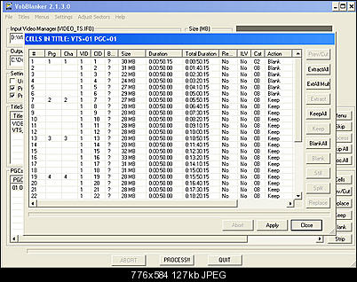

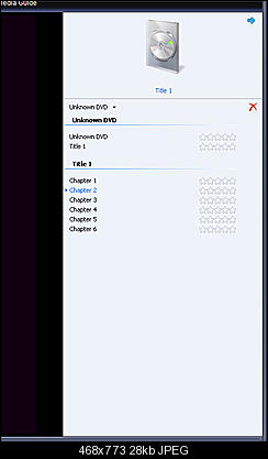

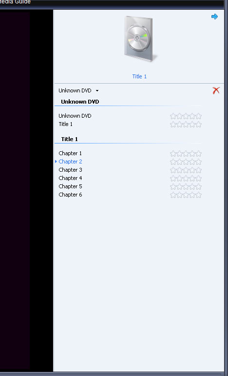

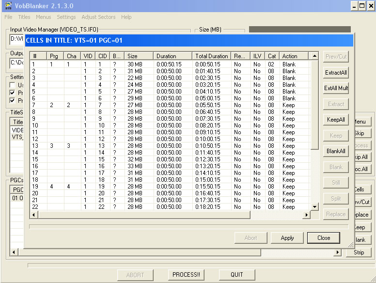

  5. Yes, chapter 1 shows blank and doesn't play when I open in Windows Media Player. What I meant was that the Chapter 1 title still shows up. That is what I wanted to remove. When I open the cells window all of them show blank for chapter 1.
    I added a couple of screen shots below to try to explain better.

  6. What are you showing me with that VobBlanker cells screen, the original DVD before blanking? After blanking it should have almost no size and last almost no length. I ask again, why do you want to remove all traces of it since, when played, you'll notice no glitch or anything at all to indicate there's a chapter there?

    I went ahead and burned what I had done originally and the new DVD no longer has the first chapter (It starts right on the 2nd one). The first chapter does still show up even though it is blank (That is what I was showing in the screen shot)).
    The disc plays fine - I was just wondering why chapter 1 still showed up on the new disc after removing it.
    If there are now only 5 chapters why does it still show that there are 6 even thought the first is blank?

    The other screen shot was of the VOBBlanker cells screen after blanking...

  8. If that VobBlanker pic is of the edited and finished DVD, then you did something wrong. After blanking there should be just a single frame black screen. The chapter doesn't get removed, only blanked. This way menu navigation is maintained.
    That's right, VobBlanker doesn't remove it. To remove it completely is a bit more difficult, and PGCEdit is the preferred software for that. But it may also require some additional work afterwards. If you want to try, open the DVD in PGCEdit. Double-click on the video and in the new 'PGC Editor' screen hit 'Remove Cells'. In the new 'Remove Cell' screen go Remove Cell->Cell 1 (which is the default setting). I didn't do anything after that as I didn't really want to remove a cell in the DVD with which I was testing. There may be some messages and warnings.
