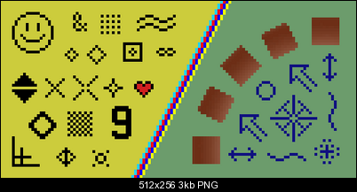

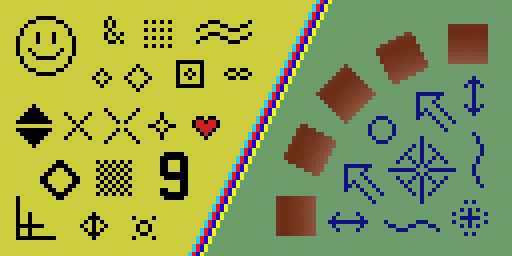

  12. There is a special AviSynth filter called PointSize (hq2x(), hq3x(), hz4x()) that can enlarge un-antialiased graphics with smoother lines:
    http://en.wikipedia.org/wiki/Pixel_art_scaling_algorithms
    Original:
    PointResize(), AKA nearest neighbor:
    BlinearResize(512,256):
    LanczosResize(512,256):
    hq4x():

    Probably, but that's probably because of how the encoder stretches it. I would at least expect a bilinear blur, but artifacts?
    I tried not changing the size and there's still artifacts and pixel blurring.
