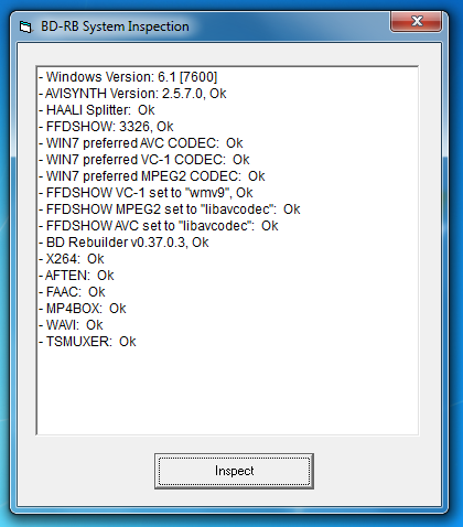

  4. Another thing to check: open your bdrb folder and run the inspect application to make sure everything says ok. You may be running the wrong version of avisynth, haali splitter, or ffdshow. It should look like this:
