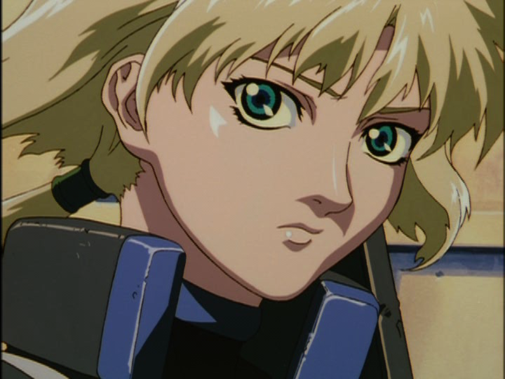

  12. The video was encoded using Crop(2,0,0,0) LanczosResize(656,480) (Sharp)
    And the screen was taken from the original :
  13. When someone requests a sample it usually means a sample from the untouched source, not a reencode. Anyway, the crop values are:
    Crop(4,0,-2,0)
  14. Many thanks and sorry about the sample..
    Sorry to ask this again, the crop values are good with 656x480, right?
    Thanks again
  15. It's kind of in between 640x480 and 656x480. Me, I'd crop a bit into the video and then resize to 640x480, like so:
    Crop(8,0,-8,0)
    LanczosResize(640,480)
    Or, you can not crop into the video and then resize it to 640x480, which will leave a bit of an aspect error, but nothing too serious.
  16. Ok thanks I will give it a try
