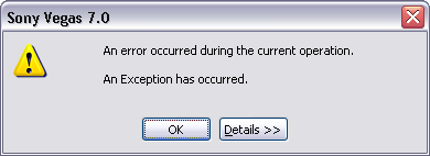

  7. I installed tsmuxer and it works great so far, the quality is, if I might say even better, with the same small size and Vegas actually recognize the vids; but the problem now is in vegas: when I click to import a vid and this browsing window pop up, and the cursor just stands on the .m2ts vid - I don't even click on the vid, Vegas crashes (every time I tried). Sometimes I get this ..
    Also on lagarith, huffyuv and ut, I installed them but I can't see any change. What am i supposed to do with them?
  8. you can't get better quality that the original. It's just that you're used to seeing lower quality wmv
    with lagarith etc... you to re-encode them . eg. use vdub with mkv plugin , or avidemux and encode with huffyuv. When using lossles codecs, the filesize will increase - probably 5-10x as large , but this is just for importing purposes - so you need lots of hdd space
    I don't think vegas 7 supports h.264 , that might be why you get that error
