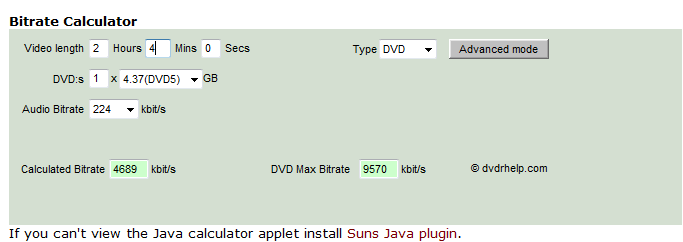

  4. OK, I think I will archive the tapes to an external hard drive.
    But what about an EASY app for me to get at least two of the D8 tapes onto one DVD?
    I have Nero ( older version ) I use for music, but it always seems to have a problem somewhere along the line.
  5. Member edDV's Avatar
    Mar 2004
    Northern California, USA
    Two 62 minute D8 tapes require an average bit rate of 4689 per the bit rate calculator. Use less, ~4600 and two pass VBR to keep the file size under control. Encode interlace and lower field first.
    https://www.videohelp.com/calc
    At that bitrate, handheld D8 quality will be poor. Suggest you do one tape per DVDR5 disc @9600 Kb/s instead. Try both ways and decide for yourself.
