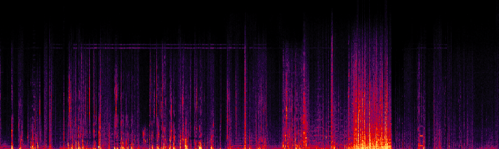

    I ran a quick spectrum analysis side by side of a Cinavia protected audio file, and a non protected sample. If anyone would like to review the results, it's an excel file and can be downloaded here
    http://www.webng.com/nukeya/comparison.xls

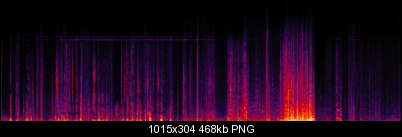

  15. Disgustipated TooLFooL's Avatar
    Feb 2004
    Opium Den
    i TOLD you guys this is some pretty advanced coding, and its not gonna be a 'simple bandpass filter' that defeats it! the Doom9 forum has been active with people re-encoding the movie over and over again with every tool they have, but the protection remains every time.
    someone on Doom9 also did a 'spectrum analysis', what exaclty is that? they produced this picture..

  16. Member Cornucopia's Avatar
    Spectrum analysis is basically a graph of a clip (very short window) that shows Increasing Frequency on the X-axis and Increasing Amplitude (Loudness/Volume) on the Y-axis. Advanced versions have a Z-axis that shows the subsequent time windows.
    Looking at that supplied graph tells me there is either something wrong with the window/application, or there is something fooling it (through PulseWidthModulation), or there actually is a fairly stead volume (@ 3/4 of the way up = loud) all across the board.
    No, on second thought, this graph looks more like it's got increasing amplitude shown as brighter/hotter colors, so the Frequency is likely the y-axis and Time is the x-axis. In which case, you've got what looks like 2 narrow bands of (upper) frequencies that is steady (indicative of a pilot tone?).
    I don't know, I think it's still hackable. But it would probably be a good idea for there to be an online database of players that DO and DON'T support it, so people can know what they're getting into. I'm sure "THIS MODEL UTILIZES CINAVIA DRM COPY PROTECTION" isn't clearly labelled anywhere on the box.
