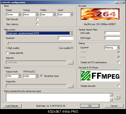

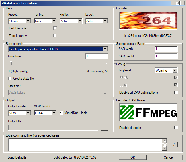

    At any rate, when I go to configure x264 from my editor, this is what I get:
    As far as I can tell, there is no option for changing the GOP size.

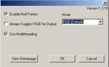

    So... with that being said, that was another reason why I chose lagarith. Continuing with this topic, I am about to try lagarith as I type out this post. From what I gather from reading the description of the settings, these settings should work best for me:
    From what I read about null frames, using them would be a perfect application for my type of videos. Let's just hope that VirtualDub will open them. I also have a quad-core processor, so the multithreading option should speed things up. Are these settings the most ideal, given what I am trying to do?
    Also, would someone care to explain what the "mode" is? You can select from RGB, RGBA, YUY2 and YV12. I've heard of them before but I don't know exactly what they are (as I've never really had to deal with them) or what the difference is between them. (I'll try RGB for my first test run since it's the default selection.)

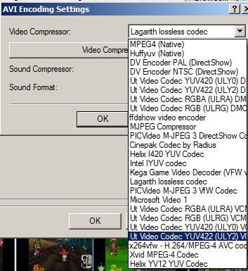

    And finally one more question. (Sorry... ) After I installed the UT video codec, I get EIGHT different options for it when I go to select a codec in my video editor.
    Which one should I use?

  5. Lagarith's Mode should be set to the same colorspace as your source (1). Or if you're filtering in VirtualDub it should be set to RGB because VirtualDub usually converts to RGB when filtering. You are correct about the other settings.
    Regarding the x264vfw settings: that simplified UI doesn't directly support all the available x264 settings. You can enter them manually in the "extra command line" box. All I frames would be "--keyint 1". It looks like you can't set the CRF/CQP value to 0 (lossless). Maybe adding it manually will override the slider: "--crf 0" or "--qp 0"

    I tried Lagarith with the above settings used and it works great in both VirtualDub and Aegisub. Actually, it works better in Aegisub since I can jump directly to the frame that I want to go to instead of having to work my way to it from a point before it. (I'm sure this is because there were B-frames in my previous intermediate videos.)
