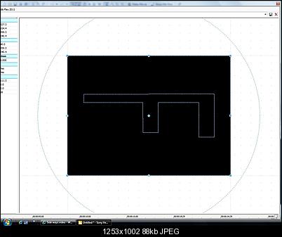

    I can with Sony Vegas Movie Studio. The video can be rotated and resized if need be to fit the screen.Click image for larger version

    It will also result in vertical black bars up each side of the video image
