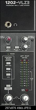

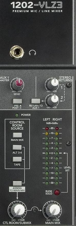

    My Mackie 1202VLZ was the original this mixer was based on. Do you have a link to the manual for your Xenyx X1204?
    The headphone concept is a control room monitor (sound isolated from the talent). The headphone is switchable in the case of the 1201 to the main mix (mixer output), the tape input (so tapes can be cued isolated from the main mix) and some of the aux inputs. Normal selection is the Main Mix.
    The Berhinger 1204 is similar where the control headset is selected in the "Source" block next to the peak LED stack. There is a headphone pot there too.

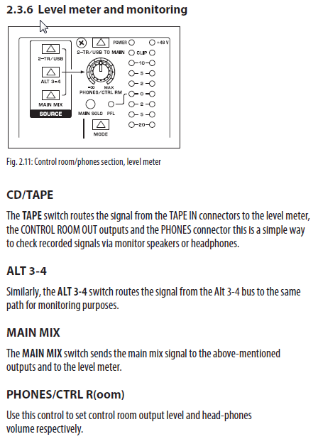

    Here is a link where you can get the manual: http://www.behringer.com/EN/Products/1204USB.aspx
    I really appreciate your help Ed, can you explain that again in very lamens terms? All I want to do is be able to wear the headset so I can here all the voices going into the mixer AND the music/effects, etc... at the same time so that I can properly adjust sound levels to where they need to be.
  6. The headphones can monitor the final mix, or some of the inputs before the mix. Use the buttons in the last of edDV's images to determine what you're monitoring: 2-TR/USB, Alt 3/4, Main Mix. See page 9 of the manual for details.

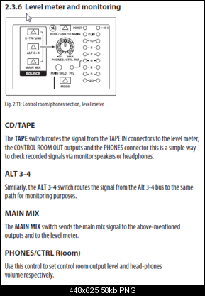

    This is what the Behringer manual has to say. I agree you need some experience to interpret this. Ask again.
