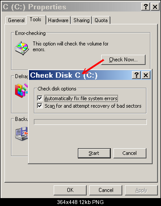

  3. Your problem is NOT a file copy problem. It is an error either reading from, or writing to, one of your hard drives. Run a disk error check on both.
  4. Check Disk (CHKDSK) with the "Scan for and attempt recovery of bad sectors" option enabled is designed exactly for this. It will read through each file and attempt to recover data in any bad sectors, move it to another sector, then mark the bad sectors so they aren't used again in the future. Obviously, if the data is too badly damaged it can't be repaired. But at least the bad spot on the disk won't get used again and you'll be able to access the file(s).
    [Attachment 5167 - Click to enlarge]
    I will definitely give this a shot, thank you.
