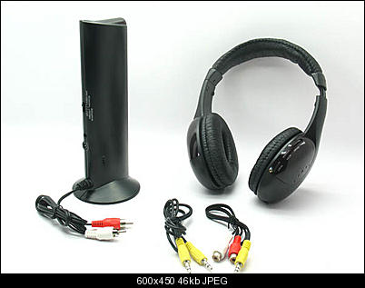

    CRT TV, have no standard 3.5mm Audio Out socket for headphones. It have is RCA AV OUT at the back side. Does it possible connect Wireless Headphones to this RCA Audio Out sockets?

  2. You say it has a/v out at the back, connect red/white wireless headphone connectors to the red/white RCA's on TV. If you only have one audio out on the TV, connect the white RCA only. This should give you a mono audio signal.
