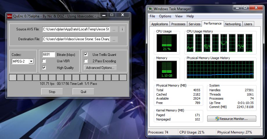

  1. Hi, I need some advice with avs2dvd, before was my first run with my new comp ( win7 corei7) and quenc converted a 1 and a half hour movie in 20mins audio encoding took 2mins all that ran pretty low cp usage but quite fast then muxibng took 10mins and was only using 4% cpu though ram was going crazy with 100% being used and 0 free now this is a new computer and there's 4gb ram installed. Does this mean I shoulkd upgrade my ram to 6 or 8gb?, the manual says it capable also I had IDM and firefox/ Internet security updating/which didn't do my when I closed them also is it normal to have two ffdshow vid/audio open in taskbar and 4 haali splitter open when only 1 of each installed?.

  3. ty gunslinger for the ffd info I gues that's just how it is, thoguht i'm still having problems with my ram over use by not avstodvd but dgpulldown muxman when avstodvd runs them muxman's fine by itself here's a screenshot of ram using dgpulldown (taskmanager by itself) and here's a SS of quenc and what resources it uses:
    see dgpulldown eats all the ram 0free and as a matter of fact my third movie failed after quenc finished maybe cause it was batched and ram is overloaded?? so I'll do it by itself still think it's normal?
  4. Click image for larger version
    normal ram using quenc^^^^^^

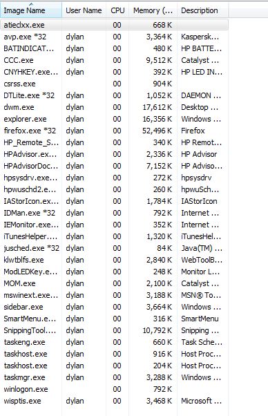

  5. Always Watching guns1inger's Avatar
    Apr 2004
    Miskatonic U
    I would be interested to see the process list, sorted by ram usage, while this is happening
    Read my blog here.

  7. The before images are when it was encoding the audio, now this is when muxman is authoring it has 0 free memory so everything sorter freezes and I also have the process list while muxing.

  8. and this is when everything is idle nothing except the usual is running, also when my computers idle it has 2300 meemory free, so far dgpulldown wavi and muxman eat the memory but not when i'm encoding. do I need a ram upgrade from 4gb to 6 or 8 as it's cheap and everything else is running fine. ?
  9. Always Watching guns1inger's Avatar
    Apr 2004
    Miskatonic U
    Make sure you tick show processes from all users, and sort the processes by ram usage so the highest is at the top (click on memory) at the top of the column to re-sort. If you still don't see a process hogging the ram then is it mostly likely something that has a memory leak so the system doesn't see the usage, it just knows it's gone. Again, upgrading your ram won't help, as the leaking process will just use that as well. You could look at a better system information tool to try to find it, or you could report it to the author to AVStoDVD to see if the same issue has been reported elsewhere. Just drop a post at the end of this thread and he will see it.
    Read my blog here.
  10. You see i'm rather new to win7 and I have basicly default settings and it's fast with i7core, so I feel everything runs fine just when avs 2dvd is running it's all the bundled software that is hogging or caching the ram. the only processes running by all users are kaspersky processes and it's running as you see, also I think my computer reserves alot of memory that's why the ram isn't maxed out only 33% usage and there's 0 free I might get some tech help if no-one can help. also i'll read a few forums for an answer. thanks guns1inger.
  11. Always Watching guns1inger's Avatar
    Apr 2004
    Miskatonic U
    Everything looks pretty normal except for the odd memory usage during the muxing phase. This is why I suspect that muxman, or something else running during that phase, has a problem with leaking memory. There is nothing you can do about it, as it is a programming issue, not your machine. And it appears that the memory is released once the process completes, so it isn't causing any long term issues either.

  16. No other users reports about this issue.
    Just to make some order. Looking at first attempt images:
    - During QuEnc encoding: 2924/4055 MB available memory
    - During MuxMan authoring: 2743/4055 MB available memory
    - During DGPulldown step: 344/4055 MB available memory
    It seems that DGPulldown is eating almost all your memory. Frankly speaking I have never checked if DGPulldown is so hungry, it calls so many I/O instructions that I usually leave it to complete that heavy process without trying to do anything else. From your side, did the first project ended successfully, even if it locked your PC for a while?
    Second project is another matter. You faced some troubles in audio encoding step and we have to investigate why.
