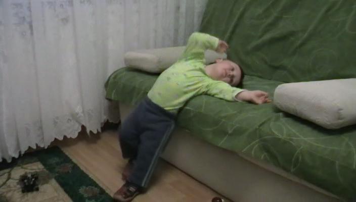

    original
    script
    AVISource("test.avi")
    Santiag()
    SsmoothLevels(22,1.5,255,0,255,chroma=100)
    Tweak(sat=1.1,coring=false)
    FFT3Filter(plane=3,sigma=3,bt=2)
    FFT3Filter(sigma=1,bt=2)
    LSFMod(strength=50)
    As usual tweak to your own tastes
    PS does the dog food lablel say "jagabo" ?

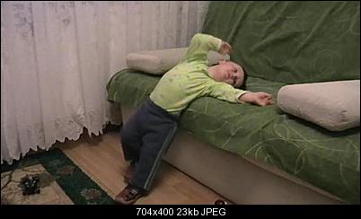

  5. before:
    Assuming the curtains are white (sorry, I can't do white balance in YUV):
    ConvertToRGB()
    RGBAdjust(r=0.89, b=1.02)
    My guess is they are not quite so white though. And it could probably use a little more brightness and saturation:
    ColorYUV(gain_y=60, off_y=-16)
    Tweak(sat=1.2)
    ConvertToRGB()
    The lighting is different in different rooms so different adjustments are necessary for each room.
