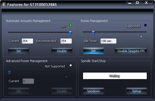

    To answer my own question again, in case anyone comes across this thread looking for the same thing, I finally found it. It's called HDDScan for Windows version 3.3. What kind of freaked me out at first was that there's one of those malware fake HDD scans that goes by the very similar name of HDDScan. To avoid getting that wrong one, be careful to get the right one from majorgeeks.com or from the developer's own page:
    http://majorgeeks.com/HDDScan_for_Windows_d6321.html
    http://hddscan.com/
    Be sure it looks like this, and it's quite easy to use.
    1. Start the program (run hddscan.exe). Obviously, you should keep the whole program folder, which includes the hddscan.exe file, on your C: drive or one that won't be spinning down.
    2. Select your drive on the left, hit the big button in the middle, and choose Features > IDE Features.
    3. Under Power Management, move the slider to set the Idle Timer for how soon you want the drive to spin down after being idle. Click Set.
Name:	HDDScan for Windows Features Power Management.JPG

  6. Member p_l's Avatar
    Montreal, Canada
    Even when spun down, the drive is always visible in Windows, even over a network. Whenever you access it, it automatically spins up. It then automatically spins down after the selected idle time.
    The Spindown and Spinup buttons in the bottom right corner are manual commands.

    Just want to say THANKS p_I for the info, just what I was looking for, perfecto~~~
    Unfortunately, after clicking set, none of the settings stayed. So basically, doesn't work anymore...

    Are you sure you did this, on the computer the HDD is attached to?
    Mar 2003
    China
    Yep, of course p_I. And gregalan, in my situation, the drives are not networked, but that didn't matter, power options setting the disks to shut off after some time doesn't work either.
