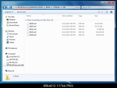

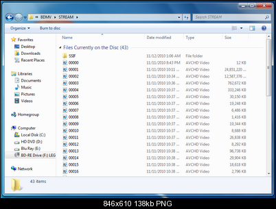

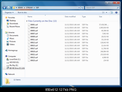

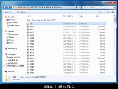

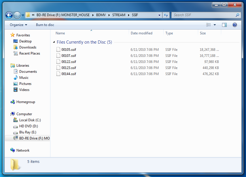

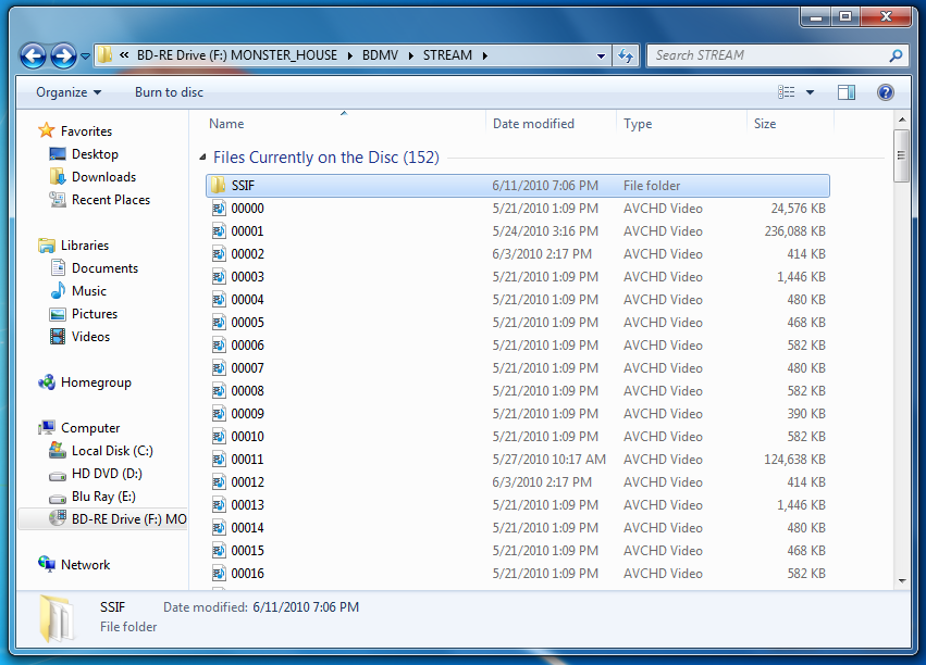

  11. 3D content is stored on the disc in SSIF files.
    Monster House in 3D
ID:	5686Click image for larger version

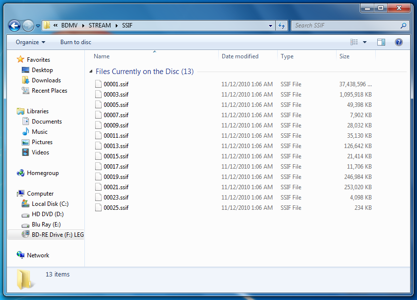

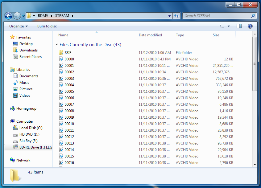

    Legends of the Guardians The Owls of Ga'Hoole
ID:	5688Click image for larger version
    How to encode these into avi or any other format, I don't know.

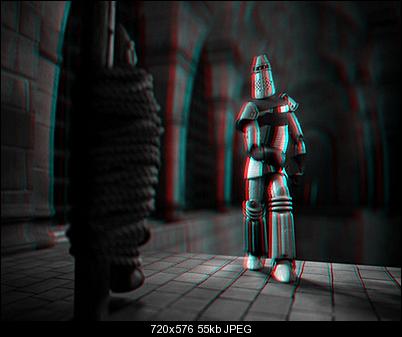

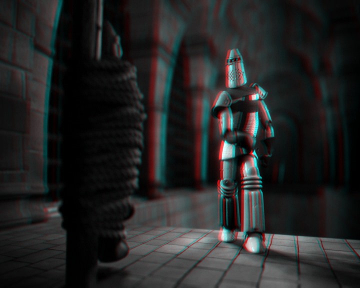

    Windows Media Player 11 supports 3D. From what I've seen the frames are placed side by side in the WMV file:
    http://www.nvidia.com/object/3d-vision-3d-movies.html
    This AviSynth script will convert for red/blue anaglyph glasses (red filter on the left eye):
    DirectShowSource("Knights_Quest_576p.wmv")
    ConvertToRGB()
    GrayScale()
    left=Crop(0,0,width/2,height)
    right=Crop(width/2,0,width/2,height)
    red=ShowRed(right)
    green=ShowGreen(left)
    blue=ShowBlue(left)
    MergeRGB(red,green,blue)

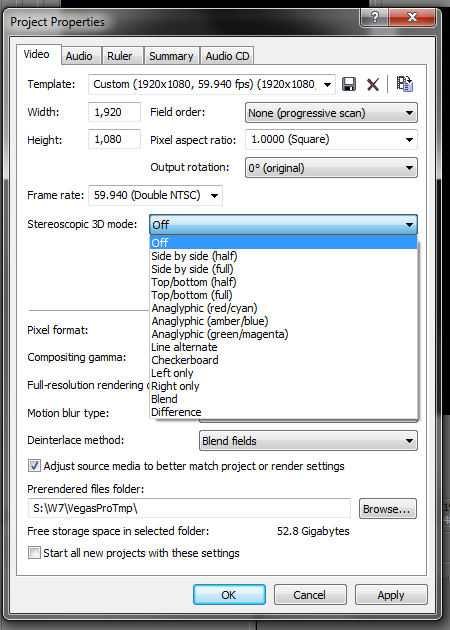

  21. Member edDV's Avatar
    Mar 2004
    Northern California, USA
    Originally Posted by therock003 View Post
    Ok understandable. So for the moment is there any particular way to encode 3d content into mainstream containers like .avi or .mkv and any software player (mediaplayer classic,vlc, kmplayer,zoom player) that knows how to playback those files?

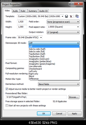

    For what it's worth, these are the 3D project modes supported in Sony Vegas Pro 10 for creation of 3D.
    http://www.kiva.org/about
