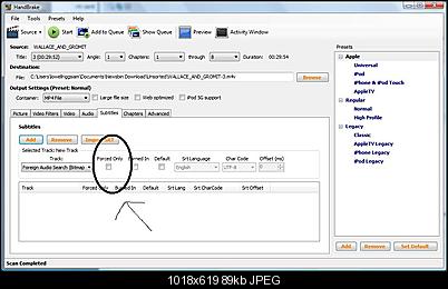

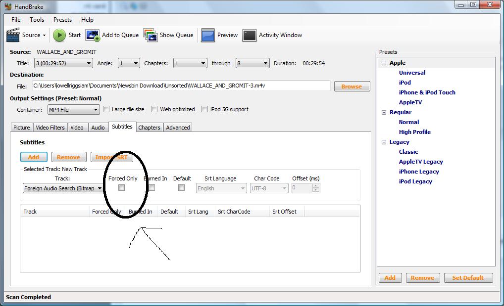

    If you can rip the blu_ray using makemkv then you could shrink the mkv file with handbrake check the box that says forced subs and make sure the srt is set for your language. It should work.
