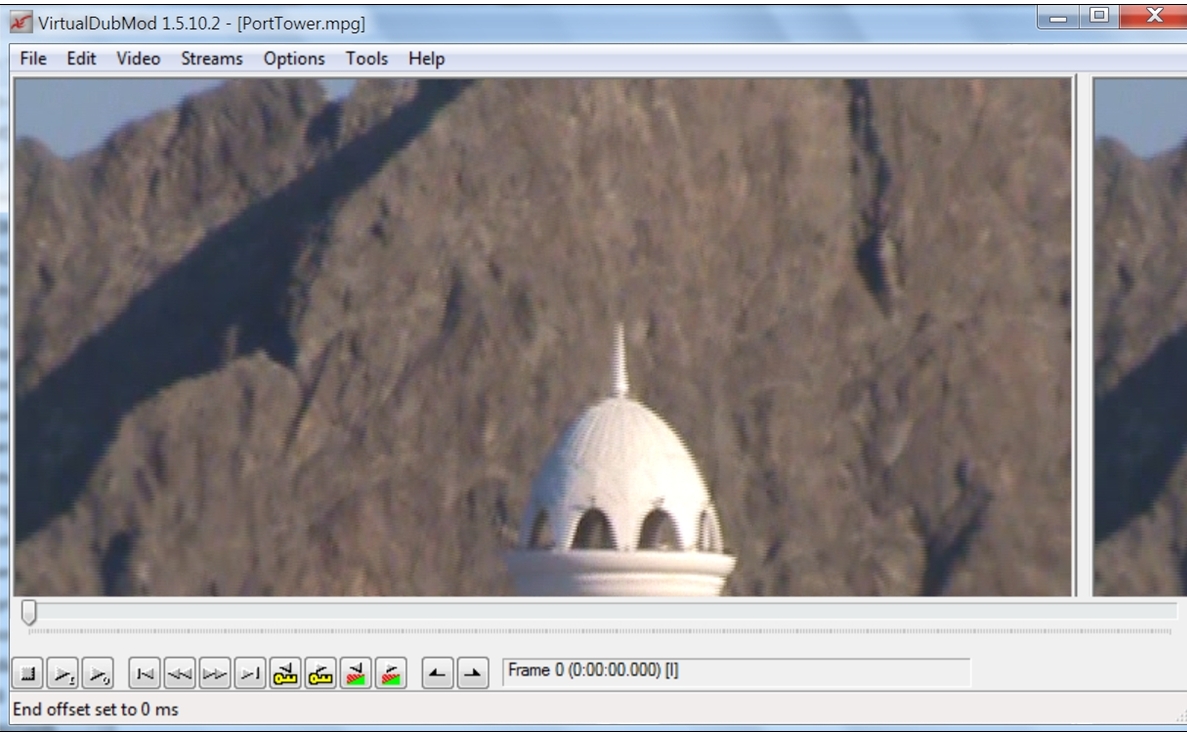

Hi. I use a Sony Handycam DCR-SR37 HDD. It produces output in MPEG2 format. I sometimes zoom-in to a distant object. The more I zoom-in the more the vibrations affect the quality of the film. Now I am looking for some means of decreasing the effect of these vibrations. I converted the MPEG2 into AVI using Vdubmode and stripped the audio from the AVI using Vdub. Then using Avisynth I increased the number of frames 5 times, thinking that this will give a slow-motion effect to the film and decrease the impact of vibration. But this did not help. I wish to know what can be done to solve this problem. As a continuation of the solution what should be done to resynchronize the audio and video. As video software I use Sony Vegas Movie Studio 9 and Sony DVD Architect 4.5. I also a have an extensive collection of tools. Help will be deeply appreciated. Thanks.

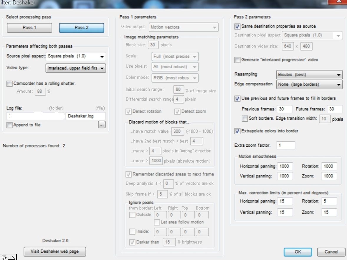

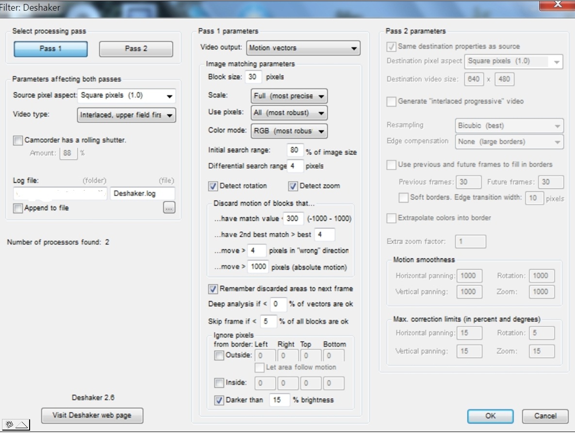

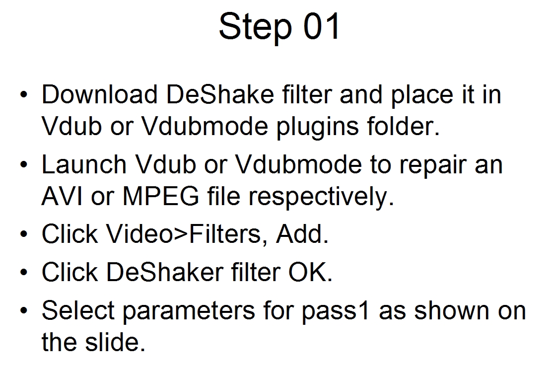

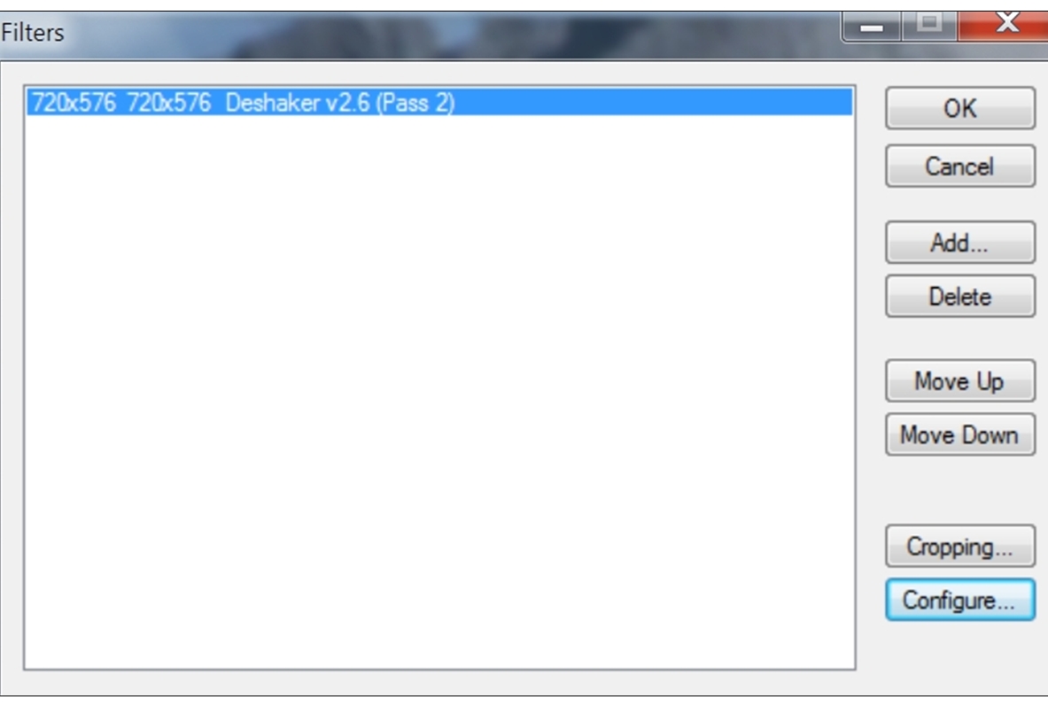

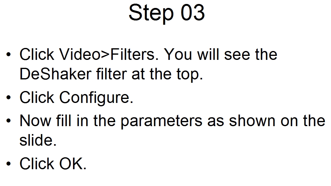

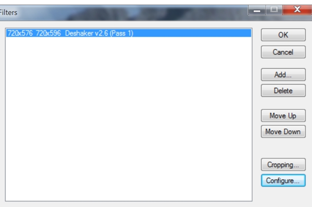

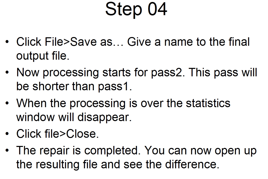

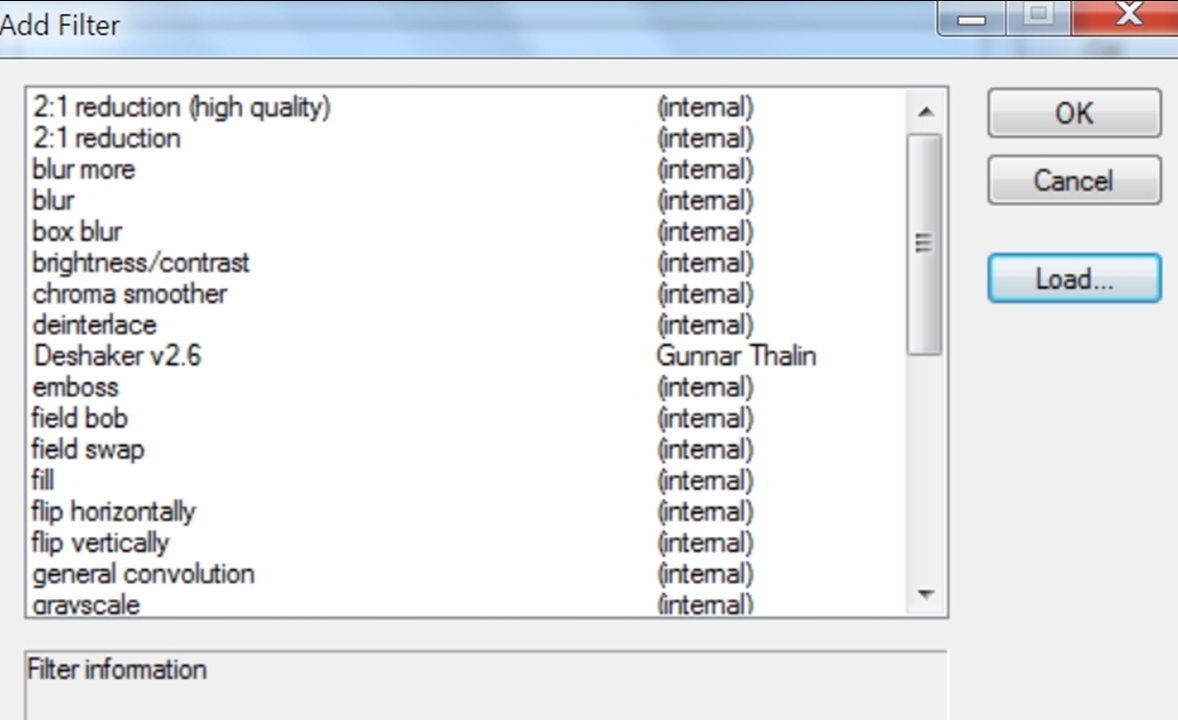

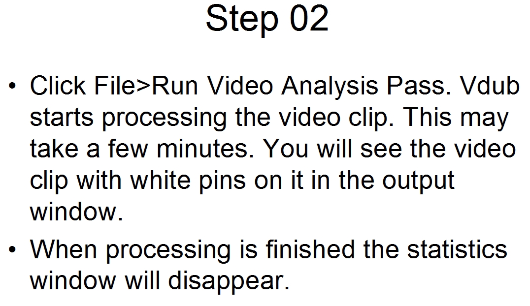

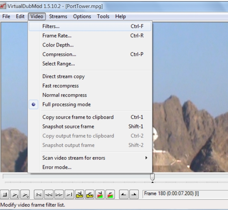

Here is a tutorial for decreasing vibration effect in a clip using DeShaker filter in VirtualDub.
[Attachment 5153 - Click to enlarge]
You can experiment by modifying the parameters for pass1 and pass2.
Last edited by SearchQuality; 14th Jan 2011 at 10:51. Reason: Modifications based on comments of users.
