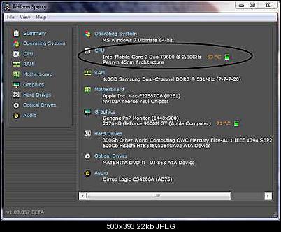

    @jagabo - advice on program to monitor CPU temp? I see Real Temp and Core Temp advertised online.
    Speccy works good and it's free

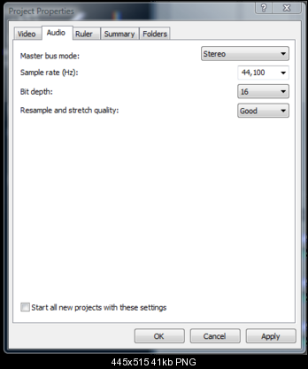

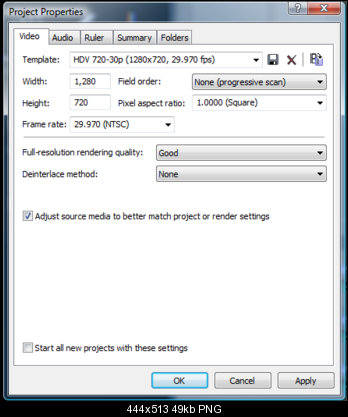

    The Canon PowerShot SX200 IS camera writes to a Quicktime mov wrapper. Need to install proper Quicktime version first.
    Then try these project settings
