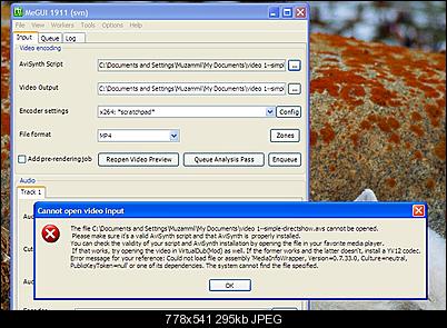

    I get the following error when i open the avs script which is to be inputed to megui created using avisynthesizer

  11. fix your directshow codecs (do you have haali media splitter installed? ffdshow? ) or use ffmpegsource2 to load your video
    http://code.google.com/p/ffmpegsource/
    aud=ffaudiosource("video.mkv")
    vid=ffvideosource("video.mkv")
    audiodub(vid,aud)
    the profiles are different between your 2 videos, one is L4.0 , the other is L4.1
    use "--level 4.1" to force it to match (or there should be a setting in the gui you're using)
    there maybe other differences, but the sample you gave has it's metadata erased. If it's the same as post #1, there are many other differences

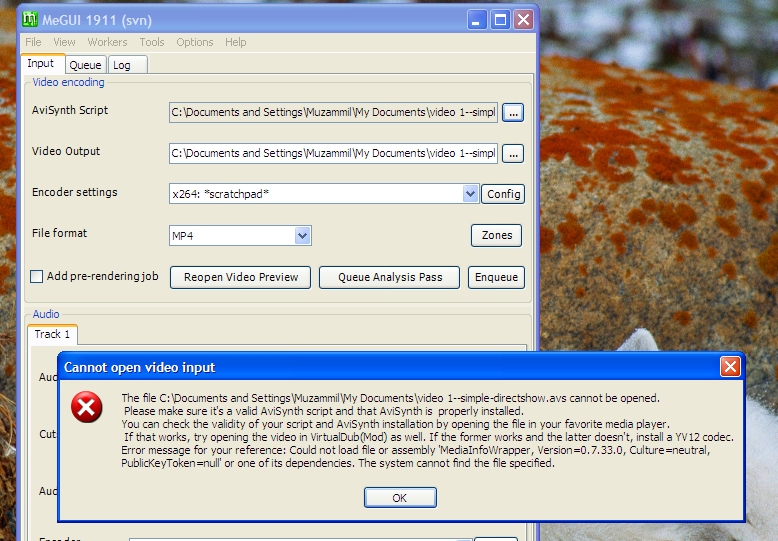

    thanks poisondeathray after i installed ffdshow, haali media splitter the avs script opens on media players but when i input it to megui it's showing following error

    installed yv12 codec still doesn't work!!!!!!!!

    Not sure what's bugging MeGUI, but sometimes - SOME times - you can close and restart MeGUI for errors like this and then it behaves.
    But, if you're having a problem with codecs/filters/splitters, you can encode it to a lossless format instead, such as HuffYUV with VirtualDub, and work with that.

  17. Don't use directshowsource() , use ffmpegsource as directed above . Directshowsource() is the last resort, because it can cause sync errors, and isn't necessarily frame accurate
